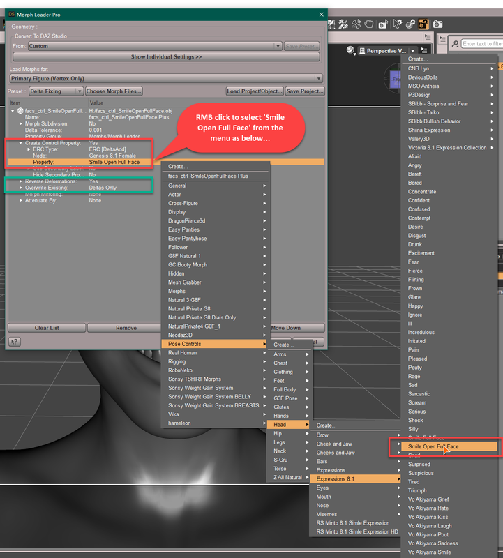

    @j11011
    Let's use Smile Open Full Face that you mentioned as the example. An FACS expression on G8.1 is not a 'true morph' but just a single Pose Control dial controlling a series of sub-expressions and bones as default, so there's no geometry data in its dsf file. You current way will not work. Now in this case, a quickest way is to create a delta morph which could be controlled by Smile Open Full Face. For instance, let's add more crease on asolabial fold based on this expression:
    1. Dial this expression 100% on G8.1F base figure. Set figure's Resolution Level to Base and export to obj file.
    2. Import obj to blender and sculpt more crease, then export to obj file.
    3. Use Morph Loader Pro to import obj file with these settings:
    4. Then when you dial Smile Open Full Face, this 'delta morph with more crease' will be automatically triggered.
    5. Save this 'delta morph' as a Morph Asset to your vendor folder.
    In this way, you're able to use a FACS control dial + any delta morph of subtle variations that you made.
    PS: You surely can create a uniqe morph based on this expression then make change on it but that'll take more steps and time, not really necessary... and you'll have no way to separately control partial expression with it..
    Post edited by crosswind on
  • j11011j11011 Posts: 32
    Crosswind, thanks for the quick response, I think I had forgotten about the "deltas only" option, that seems to do what I wanted, I didn't want the "extra detail" morph to be tied to any particular emotion, so I imported it with reverse:yes and deltas only, so I can then dial it manually whenever I want it, the only "issue" is having to remember to load it before doing any additional shaping or posing:)
    and I figured I'd try this with G9, since it has more base detail, getting this to work with G8 probably isn't feasible, since the base mesh is just too crude and mere mortals can't import hd morphs (which I think, with the recent developments in other 3d softwares, will eventually lead to people dropping Daz altogether, having to fix all issues with creditcard after waiting for PAs to finally produce a product that actually does what you want just isn't a solution)
    here's an example of almost default V9 with Smile Show Teeth at 50%, then a custom head I sculpted with bone adjustment done (not manual, the automatic one), and the 3rd one was the 2nd exported again to blender (with morphs, and had to dial in the show teeth smile in blender, and take it from there) and sculpted in the extra detail and fixes (I'm no artist btw, just a regular amateur, so don't judge too harshly :D )
    I know some of the "lizardness" can be fixed fiddling with dials and face in PowerPose, but what I was looking for is extra wrinkles, dimples and creases, and that is just too painful to do using meshgrabber, that author has their work cut out for them to add sculpting to it, not just simple mesh manipulation if they want Daz to continue to be relevant
    here the "helper" morph on the 1st head (the custom head dialed out), now if only Daz would figure out that adding assymetry to "default" expressions isn't a great idea...
  • crosswindcrosswind Posts: 9,648
    Pretty nice~ and agreed, you nearly can do anything to the figure by using sculpting / modeling tool, except for HD morphs... laugh
