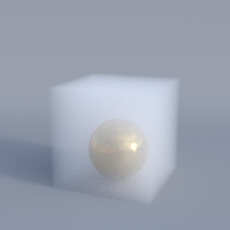

    Newest beta (just released the last couple of days I think):
    Regular Iray Uber shader. The only slots with values are:
    Refraction Index: 1.00 (this is the IOR of air)
    Refraction weight: 1.00
    Thin walled: Off
    Transmitted Measurement Distance: 30.00
    SSS Mode: Chromatic
    Scattering Measurement Distance: 25.00
    SSS Color: .54   .54   .54
    SSS Direction: .50
    That's it. The second image has a sphere in the center so you can see the density better. Only way I know of to do it with a shader. Mesh is anothers story. LOL If they're adding voxels, it's either not in the current beta available to us or it's a PA-only thing. I suspect the latter. There is nothing I can find in the beta that will create a voxel mesh.

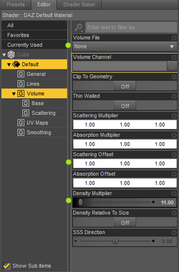

    1.  Save the Scene file in Scenes folder on your Content Library
    2. Download bunny from https://www.openvdb.org/download/
    3. Extract the bunny to your favorite location
    4. Open Scene on Daz Studio.
    5. Select Camera on viewport
    6. Enable Iray on viewport
    7. Select Volume in the Scene pane (thx barbult)
    8. On the Surfaces tab, under Volume category, change Volume File property and select your bunny.
    9. Start playing with the density multiplier, higher values make volume denser or "solid".
    Have fun.

    Thanks for this. How on earth did you figure this out???? I would add step 6.5 Select Volume in the Scene pane.

    Try lowering the density.
  • StonemasonStonemason Posts: 1,259
    edited February 2022
    yea,lower the density and also set scattering and absorptian offset to black to get rid of the blocky look

    jag11 said:
    Wow. Looks awesome.
    Yes, Stonemason's clouds look great!
