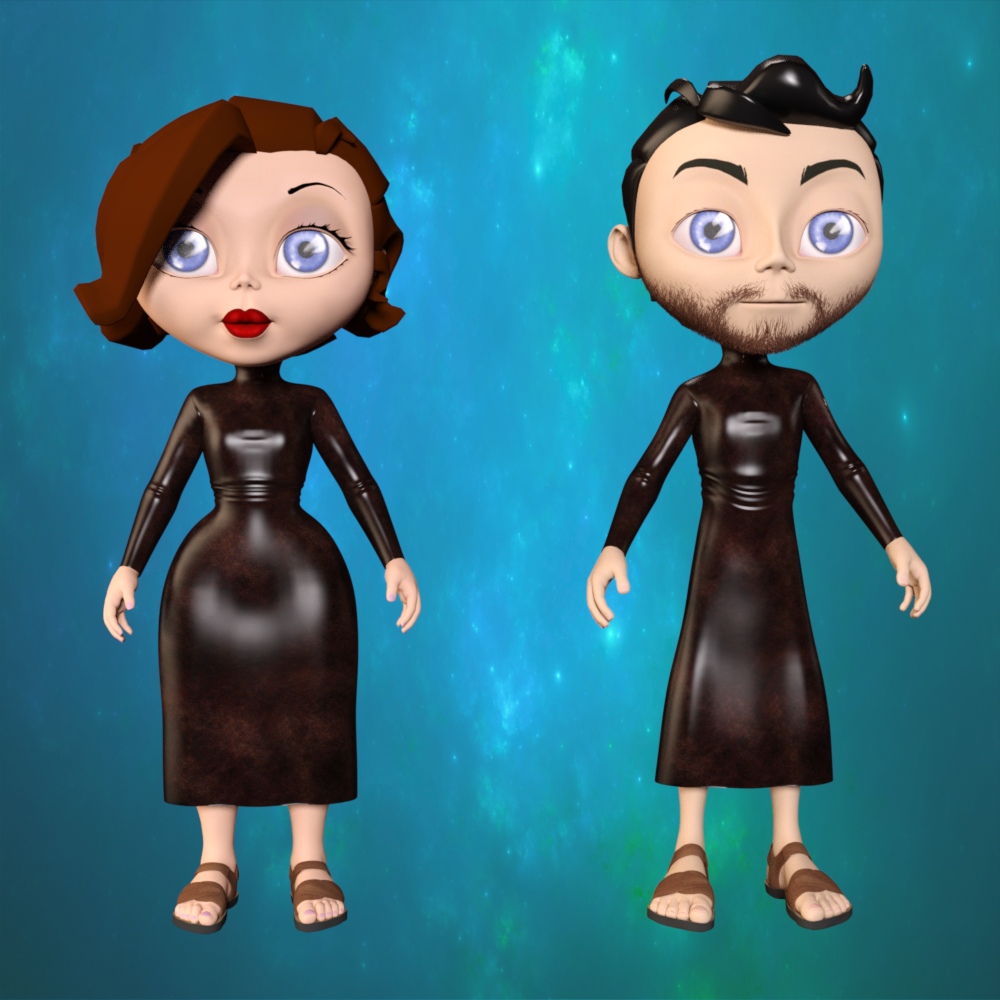

    Hope you've checked your PMs by the time you see this. If that didn't help maybe consider these guys. They are for Genesis and all [well most of them] the clothes for M4 and V4 will auto-fit to Genesis -- however there is this inexpensive set which is for Genesis and it has a tunic. The sandals were in another product and the free Genesis beard is another product. Their hair comes with the characters - simply colours.
    Pardon the atrocious lighting. {and the fact that these were using 3Delight Shaders and the render is in Iray}.
    https://www.daz3d.com/chibi-bundle
    https://www.daz3d.com/defiant-for-genesis
    1000 x 1000 - 1M

    edited February 2022
    Doodling around, made a couple morphs for a masculine figure, any interest?
    1000 x 1000 - 732K
    Post edited by Catherine3678ab on

    Absolutely interested! So how'd you make Boo a boy?
    As far as poses go, I'm just using G8F poses and tweaking them to suit Boo's body style.
    The author sent feedback. He loves it but would like the head bigger, so I've made it 300% larger. I'll send renders of that, too, if it helps. Do you plan to make a shawl and veil for her and the drape for him, too, for a set, as I suggested? You are definitely good enough that people will buy it if you make it. Turn your hobby into a side income.

    Okay then, I'll package up this particular morph for everybody that wants it.
    I will caution that it is meant for use with Bugga Boo ... without Bugga Boo dialed in, it looks pretty silly.
