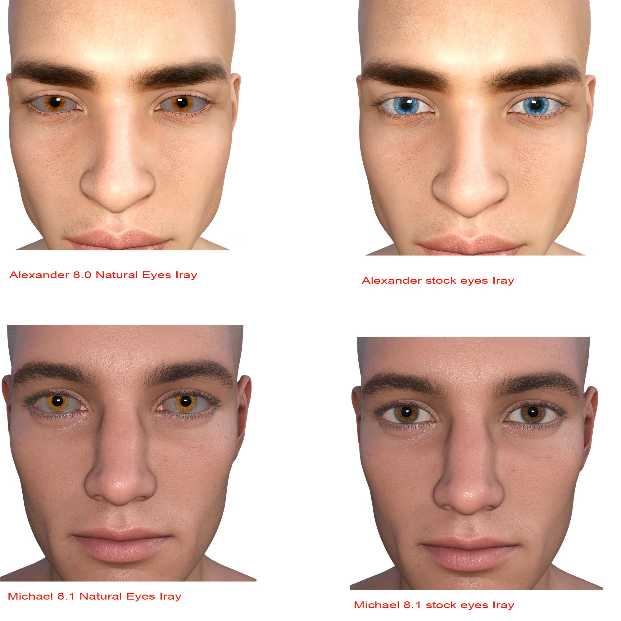

I must be doing something wrong, I always render in Iray and the
Natural Eyes II for Genesis 8.1 Females and Males Iray version comes out gray and dark.
The stock eyes seem better, less dark.
How to I get them to work right?
And I keep hearing that Michael 8.1 is PBR. I noticed a lot more parameters in the shaders tab.
Aren't the 8.1 figures supposed to be Iray to work right?
I thought PBR was 3 Delight? Is this a different kind of PBR  than the 3delight PBR?
The PBR (RSL) eyes in Natural Eyes look better but why don't the Iray ones look right and why are they so pixilated?
Why are they so dark?
Thanks in advance for any help on this.

    I have to say that these Natural eyes are "unusable" the way they are out of the box...
    I usually find later that it is something that I am doing wrong. My creed is, "blame the product last".
    99% of the time it is something I am unaware of. I can't seem to figure out how to make these eyes useable.
    I am hoping that if an update is needed it might be supplied soon. I would really like to give these eyes a go.
    Why do the RSL textures for Natural Eyes at least look like they are in the ballpark but the MDL textures look so off?

     barbult I loaded a figure into my scene that had RSL textures on it and the eyes did the same thing as the Iray Eyes did for the Natural Eyes II product.
    They pixelated and were black.
    And the eyes for Natural Eyes II actually say RSL in the thumbnail images but the ones that say RSL are actually Iray, they respond and look right. The ones that say Iray when you load them, they pixelate just like RSL eyes do when loaded into Iray.
    When I load the Iray eyes from Natural Eyes II they pixelate, just like RSL eyes do on other figures in Iray, they are also gray like other 3Del eyes are in Iray, but the textures say "base" so why they are reacting like 3delight is beyond my knowledge in this matter.
