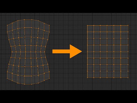

    Are you trying to make your textures curve along with the road?
    Blender has an unwrapping type called "Follow Active Quads" that'll do that for you.
    Indeed I am! watching a Blender Guru video tut on UV mapping now.

    Yeah, it's very easy once you get the hang of Blender's toolset. Here's a tutorial on how to do it:
