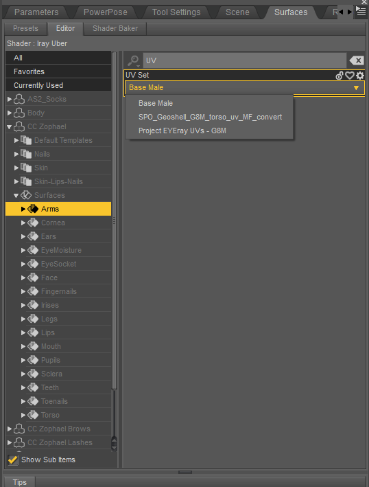

    I have not tried that and if I'm being honest, I don't even know what that means, but I'm opening up the program right now to see if I can change that. I'll google what that means as well.
    Edit - So I found the UV set for the arms in the surfaces tab, now I think it's a matter of changing it to something else.
    Edit - I found out where I could load a new UV set onto the figure, but - I'm only able to change it to obj files. The hand salon doesn't have any obj files in there, so I don't think that I can change it there.

    A UV is a coordinate that maps a polygon vertex to a texture. It defines how the texture is applied to the facets of your figure.
    I have the option to change the UVs over to Base Female, but I'm not sure if that came default or if I got an addon or something. I know there's products in the store that let you cross-fit between male and female.

    If it's gonna work you change it to "Base Male" for both the Arms & Fingernails however, it's shouldn't work. You need the Genesis 8 UV Swap product from a PA named SloshWerks. I think the full normal price for the product is about $16.

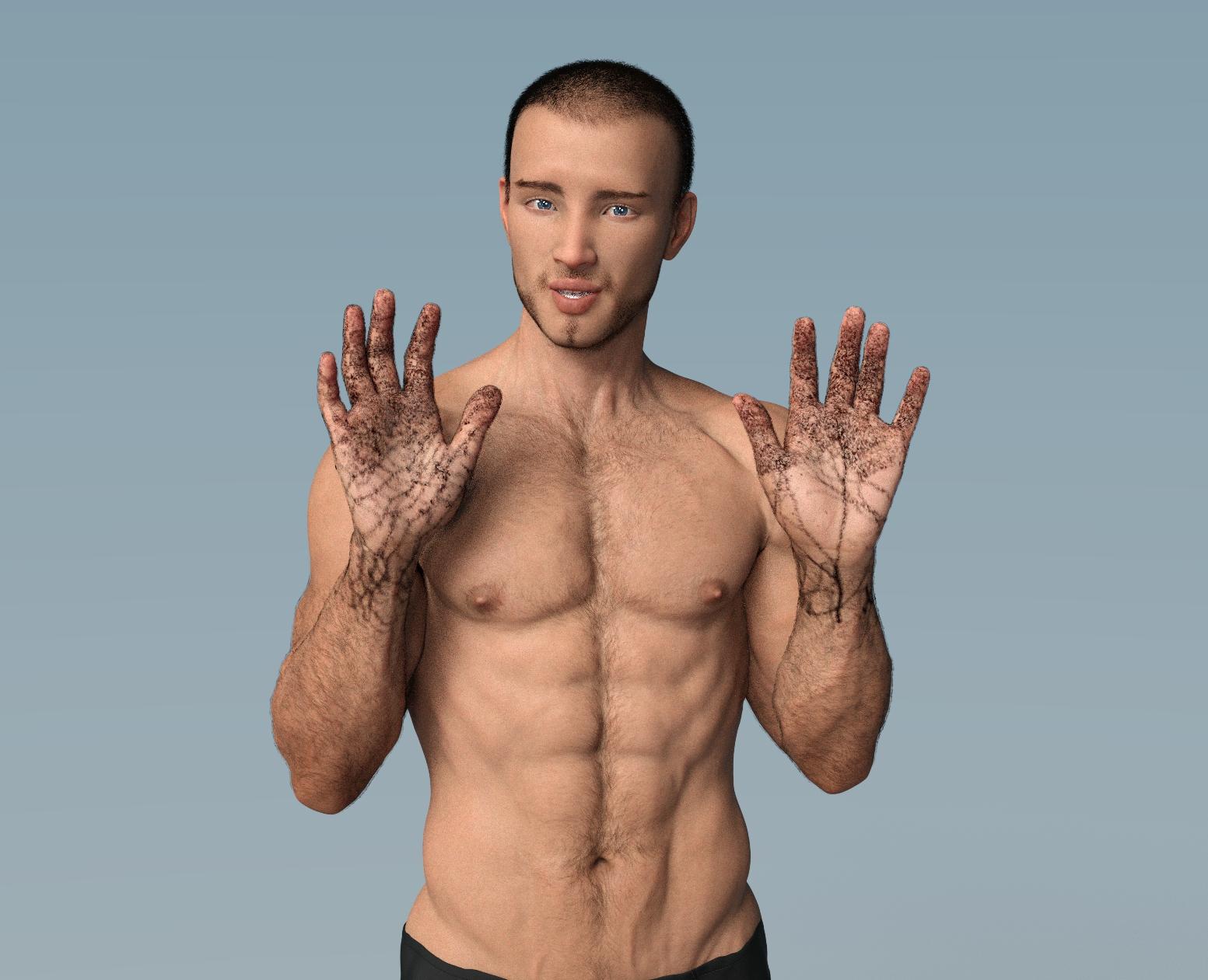

    I though about what you are trying to do (which sounds simple and neat) but I don't have the fake nails product.  This is what I tried instead as an example

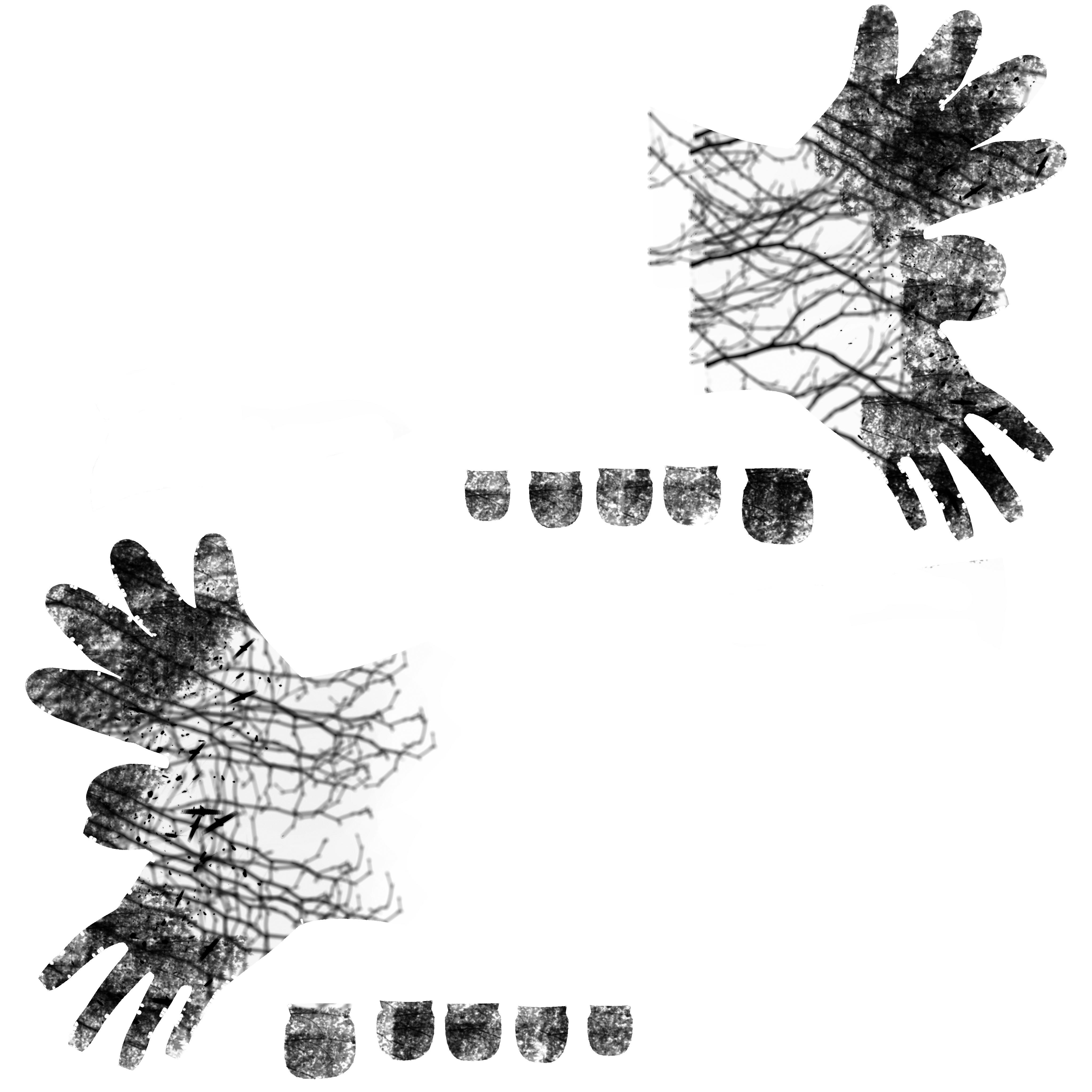

    1. I downloaded G8M's template from the Product Library (Daz3d.com > Account > My Account > Product Library > filter for Genesis 8 Essentials and download G8M template).
    2. I opened the arm template in my image editor (in my case, Pixelmator Pro but Photoshop, Gimp, Affinity Photo should work).
    3. I created an empty layer above the template, made a selection of the arm and fingers, painted in the arm and fingers (I used a tree branch pattern in this case) in black.
    4. I created a layer below the painted layer and filled it with white.  We now have three layers: painted fingers, white background, and at the bottom, template.

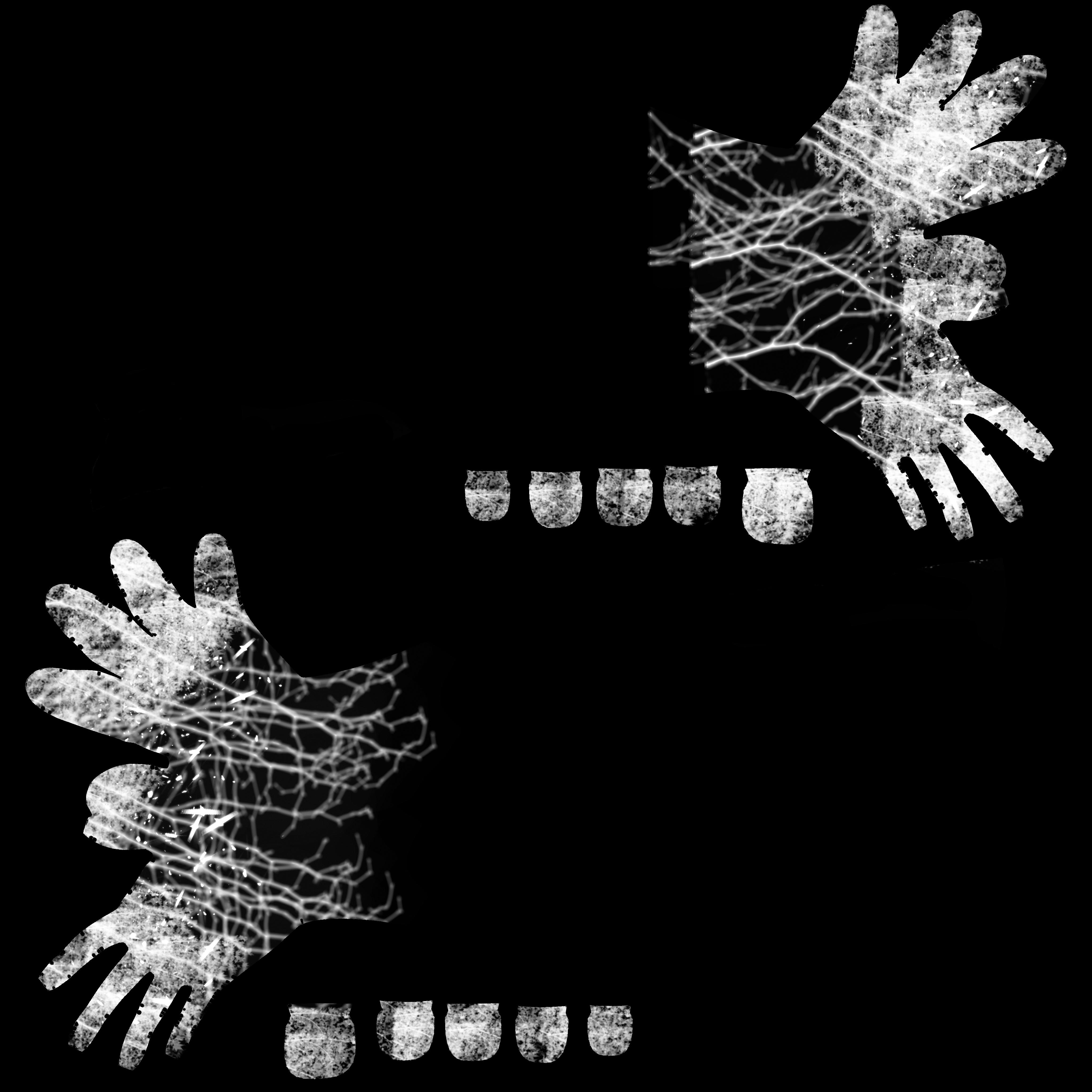

    5. I flattened the layers, saved as jpeg, inverted the colors to white painted fingers and blacj background and saved that inverted one as a jpeg to use as a mask.
    6. I now have a version of painted fingers and its inverse mask
    7. I loaded a G8M, dressed and lit him.  Next I selected him and made a geoshell. G8M now looks incased in white icing.
    8. I selected the geoshell, and in the Parameter Tab, turned off the visibility of everything but his arms. G8M looks normal but with white arms.
    9. I selected the geoshell arms in the Surface Tab, applied the default iray shader.  I next loaded the inked finger jpeg in the base color and set the color to black, loaded the mask jpeg into the cutoff opacity and set that to 1.
    10. I rendered.
    The result is seen here and i attached the two jpegs:
    You can paint whatever you want from gloppy liquids to electricity to plugging the jpeg into bump to make raised scars and save the geoshell to apply to any character.

  • nemesis10 - That sounds dope as all get out, and I appreciate you going through that stpe by step cause I surely would have messed that up trying to do it myself, lol. That is a really cool effect and I can't wait to try it out!
