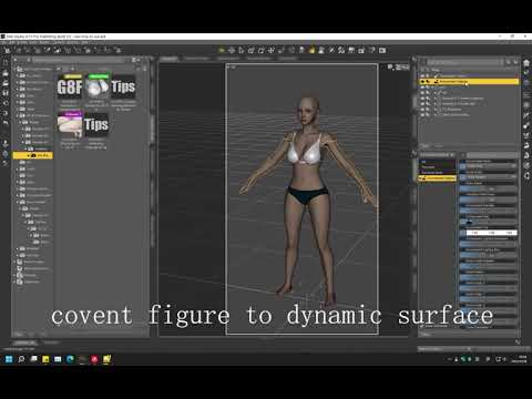

    Doesn't work for me .. boobs just collapse into something resembling scrunched up paper .. no movement .. they just crumple  ..
    However, that's when you ignore the tutorial video which says put the dforce modifier on the Genesis model .. which results in the model melting like a candle when simulation is hit ...  Does anybody at Daz check these things before putting them up for sale?

    I had this first. It happens when you apply a dForce modifier to the G8 figure without then loading the G8F material. The material is absically a dforce weight map that keeps the rest of G8F in place.
    the workflow that worked for me:
    1. select G8F, then create a dForce Dynamic Surface on it
    2. with G8F still selected, apply the HS "DFBV20Genesis 8 Female Material"
    3. with G8F still selected, load the dForce breast
    4. now select the breast attachment, and load the "HS DFBV20 Apply Matching Material for Breast"
    The thumbnails are quite misleading, as the second material is showing "Tips" on the thumbnail.
    For any of the simulation settings, make sure you have selected the dForce breats attachment. If you apply it on G8F, the figure will melt again.

    Ahh .. that seems to have done it .. only problem is now that the graft doesn't hide the underlying G8 bits and bobs so after sim, she has 4 boobs ..

    Please don't forget the most important first step,(covent figures to dynamic surface): Select your figure,right click on simulation setting tab,dforce----Add dForce modifier :dynamic surface
    and step 2:Apply HS DFBV2 0Genesis 8.1 Female Materia
  • again
    1.select figure before load dforce breast,
    2.BTW,if you are using Weight map brush tool or Geomertry editing tools, you will also see 4 boobs

    1.convert figure to dynamic surface.
    2.HS DFBV2 0Genesis 8 Female Material.(select G8 first)
    3.HS DFBV2 1HS dForce Breast for G8F v2(select G8 first)
    4.HS DFBV2 2Apply Matching Materials for Breast(select dforce breast first)
    5.HS DFBV2 3dForce Hip for G8F(select G8 first)
    6.HS DFBV2 4Apply Matching Materials for Hip(select dforce Hip first)

    D'oh laugh  Found out what I was doing wrong:  I was simulating the attachments instead of the figure blush   It works perfectly now heart
    Also found out quite by accident that the apply matching materials still works if G8 is selected surprise  Still, I would recommend @Hamster's stated workflow yes
