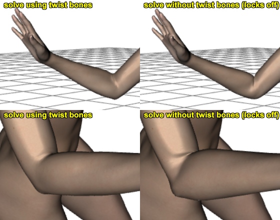

    The issue being raised is how the x,y,z rotation values are assigned in the other programs; vs. how they are assigned in DS , with it's default locks and limits enabled; and how twist bones in DS are used for weight mapping
    e.g. If we take shoulder bend/twist - In some other programs, the retargeted data is usually placed as x,y,z rotation in a single bone (the bend), instead of being split into 2 separate bones: y,z for bend and x for twist. The twist bone is present, but no data is typically placed into it.
    When the keys are imported back (either as bvh, or fbx reapplied as an animated pose preset) , the x-rot values get discarded, because that channel is locked off for the bend in DS normally. So the motion will be very off for arms and legs, because you have no x-rot values
    A common workaround used is to unlock all joints, and rotation limits off before applying motion data. And this will "work" in the sense that the motion itself will be mostly correct. Some people use this from iclone/3dx
    It will look something like this. Locks+limits off vs. default
    But the other issue is the x-rot value is now placed in the wrong bone - all x,y,z values are placed in the bend. But DS uses twist bones for weight mapping. So you get skin deformations when you do this.
    The proper procedure is to either solve or retarget with the locks in place (so x-rotation values get "forced" into the twist bone) , or afterwards in DS, you can copy/paste keys into their proper channel to get rid of the skin deformations
    Post edited by pdr0 on

    Where the bone is split into bend and twist elements (which is not, I believe, that uncommon given that each bone may have only a single weight map) DS uses clones so that setting a property on the "wrong" bone still affects the right bone.
    Yes, it's affected. They are linked in the sense that if you enter the value within DS in terms of front-back, bend, twist - the those values are automatically reflected in the twist bone below. Or vice-versa if you adjust the twist bone, that value  is auto reflected in the shoulder bend . No problem - that's fine if you do everything in DS
    But the other programs do not use "front-back", "bend", "twist" labels. They typically use different names such as x rotation, y rotation, z rotation or similar. If you toggle show hidden values in the DS parameters panel, you will see the x,y,z rotation are locked and greyed out. When you apply motion data from external source (BVH, animated pose preset) - this can cause the twist values get discarded (x rotation) because it's locked off by default. If the motion appears completely off, arms and legs flailing around - this is a very common cause
    But if you use the common workaround (unlock nodes, limits off), the x-rotation will now be pasted into the hidden x-rotation channel. You can get the deformations as shown above when the motion data is applied, because it will be pasted into the x-rotation, not twist. There will be a discrepancy between what the bend bone twist value reports, and what the twist bone twist value reports. It's no longer auto linked. And this causes those skin deformations.
    There are slight variations, but the common theme in almost every case is data in the wrong channel, or missing channel data
    Bottom line - You need to ensure the values are in the correct channel, in the manner that way DS intprets it
