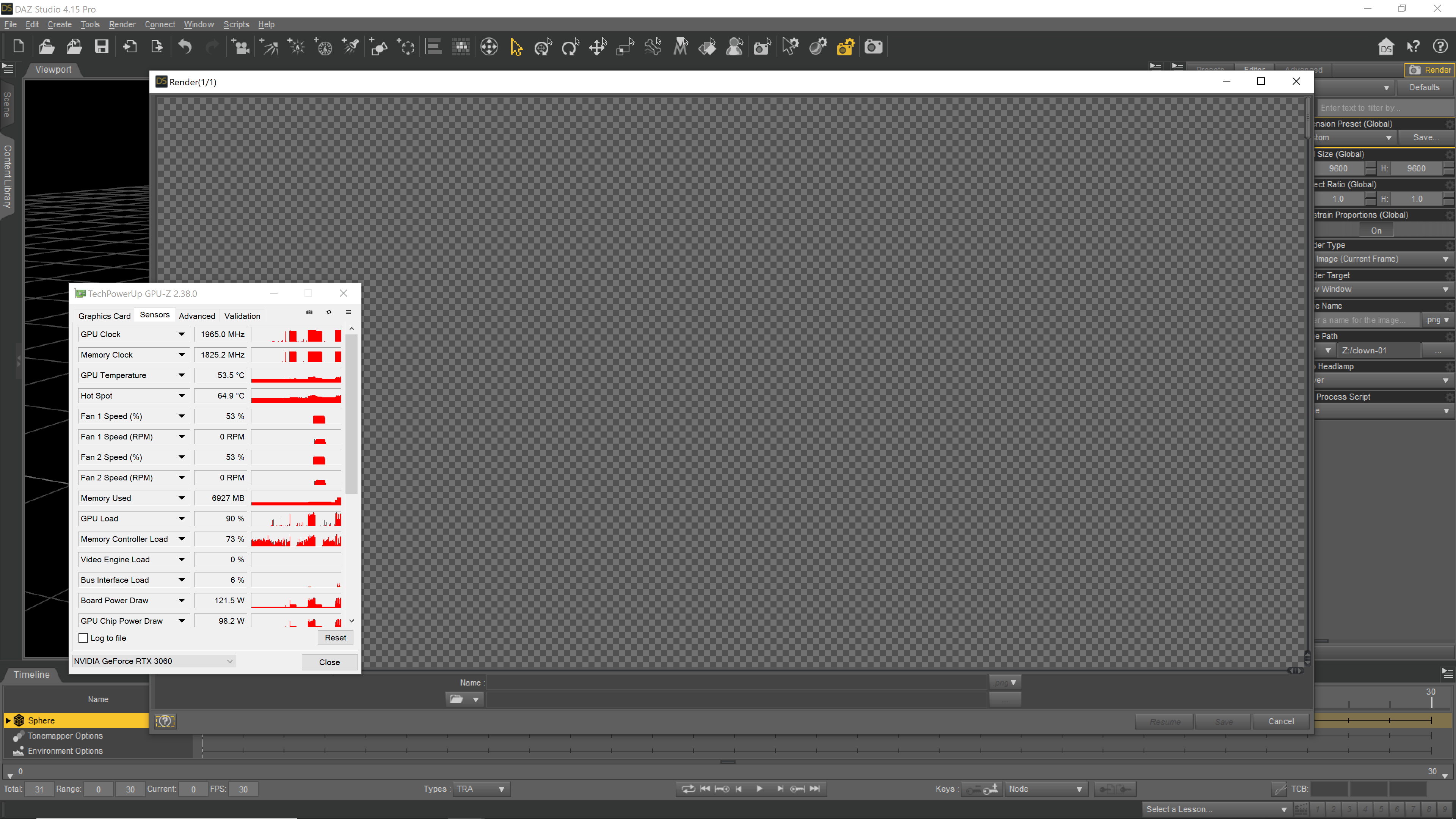

    Really?
    Same simple scene, with only the render resolution changing from 800x800, to 3200x3200, to 9600x9600. VRAM usage was 2734MB, 3176MB, and 6927MB.
    Not exactly trivial.
    - Greg

  • margravemargrave Posts: 1,822
    edited October 2021
    algovincian said:
    Really?
    - Greg
    I don't believe you, sorry.
    I only have 8 gigabytes of VRAM and I have CPU fallback disabled, so by your argument I shouldn't be able to render a 12000x12000 image with a Genesis 8 figure in it on my GPU, and yet I can.
    EDIT:
    As Richard mentioned, the framebuffer does require space on the GPU, but it's generally minimal unless you're rendering at excessively high resolution. 9600x9600 (x4 for bit depth) is only 368 megabytes.
    Post edited by margrave on

  • algovincianalgovincian Posts: 2,670
    margrave said:
    algovincian said:
    Really?
    - Greg
    You don't believe what? You're right. I faked the screenshots with the render settings lol.
    I don't think the equation is as simple as you'd like it to be. This is why it's so hard to pin down how much VRAM a given asset will use when rendered. Iray will use the VRAM differently in different situations.
    Please don't put words in my mouth. Render size effects the amount of VRAM used and it's not trivial. Try it for yourself and post screenshots from GPUZ.
    - Greg
    - Greg
    I can confirm that a primitive sphere does indeed allocate 5.7 gigabtyes of memory for the framebuffer, per my log file. However, despite only having a few dozen vertices and no materials, a Genesis 8 figure rendered at the same resolution (9600x9600) only allocates a framebuffer of 2.9 gigabytes.
    That said, that doesn't mean all that memory is required, only that it's been allocated. My log file has multiple errors about my GPU not having enough memory, only for Iray to render it anyway.
