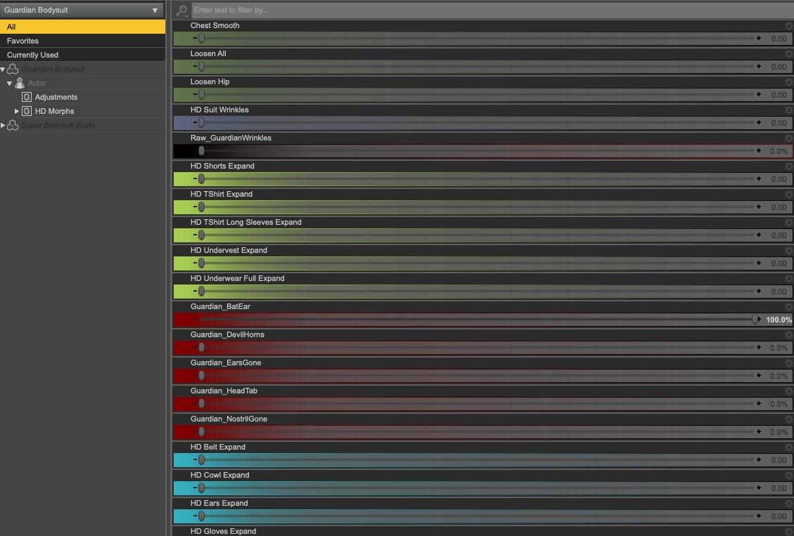

    Select the Guardian suit, go to Shaping Tab, show all:
    Guardian uses the boots from the Super Body Suit.  You can hide the cowl to use another mask.

    I don't see that when I select the Guardian Suit, go to the Shaping Tab, and select All. See screen shot.

    Ironically, I am on a Mac too!  I see those morphs in the Shaping Tab.  I think the suit is a variation on the normal Bodysuit and has its own uv's; I don't know if those morphs do anything in the guardian suit;  since the textures don't match up due to the changed uv's, I wouldn't be surprised if they were disabled... I will check in an hour or two.

    So I did a few tests....  Superhero Bodysuit (SB) and Guardian Bodysuit (GB) are sort of parent and child.  GB gives SB all of the morphs of GB but they do not share textures or UVs.  Since you have both, you can add the Guardian ears to SB.  TO see the morphs in the Shaping Tab, go to the Shaping Tab, select All and enter Guardian.....

    Well, I did the above already. No, I don't see them in the Shaping Tab. I could uninstall Guardian. But if I do that using DIM, it still leaves files on the computer, because I have the option to "Reinstall." How can I get rid of all the files so that I can download Guardian again and do a clean install?
