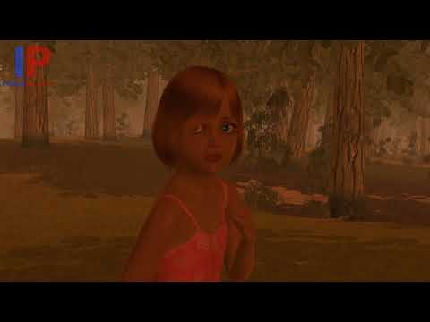

  • wolf359wolf359 Posts: 3,942
    You can send Daz figures to animate in Blender.

    @marrave Thanks, I'll look into the Diffeomorphic Blender exporter.
    @wolf359 That's a very instructive video, thank you for that! I see you are using the Diffeomorphic plugin as well.
    I know you mention using Blender to render, but is it possbile to import back into Daz as well?
    Because I don't have any experience with Blender yet (but it might be a good idea to start learning).
    edited October 2021
    Hi
    on the matter of using diffeo to send animated poses back to Daz studio.
    Yes that may work in many circumstances as the Blender IK is baked to Fk
    for things like walking,
    Daz studio can import IK to Fk baked root locomotion
    with a decent amount of  foot/floor contact fidelity
    from proper retargeting softwares like Iclone3DX or Autodesk Motionbuilder as well .
    However rigid constraint pinning
    (such as the girl is swinging on the trapeze bar at the end of my tutorial posted earlier),
    will NOT transfer back to Daz studio and the hands will fly all over the place in Daz studio.
    This is why I  personally am very hestitant to tell people to use the diffeo plugin for sending animation back to Daz studio
     despite my strong endorsement of diffeo as the BEST means to get G8 figures over to Blender for animated filmmaking& rendering with Cycles or EEVEE.
    just FYI.

    This is one of my latest clips:
    NO AniBlocs, NO BVHs and NO ready to use animations has been used there. Everything has been done with Timeline and GraphMate. Even the special effects have been made interely inside DAZ Studio. smiley
    As I said I do a lot of animations, and I tried most of the softwares you named. They are good but DAZ Studio has everything I need to make my stuff. wink Using DAZ Studio for animations is a bit confusing at first but once you grasp it, everything goes smoothly and good. And some of the bugs which pesters latest versions (I'm using 4.12.0.86) makes things a bit harder, but still DAZ Studio is agreat software for animations.

    @Imago That animation was superbly done, Bravo!  I really liked the reactions and action. Keep up the good work.

    @imago animation is cute but Compare it to any similar "cute kids" animation created by any experienced animator in Blender Maya ,Max and you see that while he has meticulously avoided foot slide during forward locomotion, his actors  movements are "floaty" and lack weight and there are no solid sustained "holds"
    The appearance of an actor having weight when interacting
    with rigid objects in their environment (floors,seats ,walls etc)
    is only possible with proper the  IK solving that his posted animation lacks
    look at how this guy creates a sense of weight in less than 2 minutes in blender

    I know DAZ Studio still lacks of a good IK system but still it is really good for animations. laugh I'm trying to have those fixed since G3 came out, which had the most horrible IK system ever and they kept that trend in G8 too. That's why I do my works with Genesis1 which is absolutely perfect for animations.
    About your example... Well, the final render looks pretty unnatural to me, even less natural than my poor attempts.surprise  Too much linear and it has a lot of jankiness.
    Anyway, let's keep the thread clean, the question was "can I animate in DAZ Studio" and the answer is "Yes you can with a bit of good will". laugh If you need more, just export to Blender or Maya.
