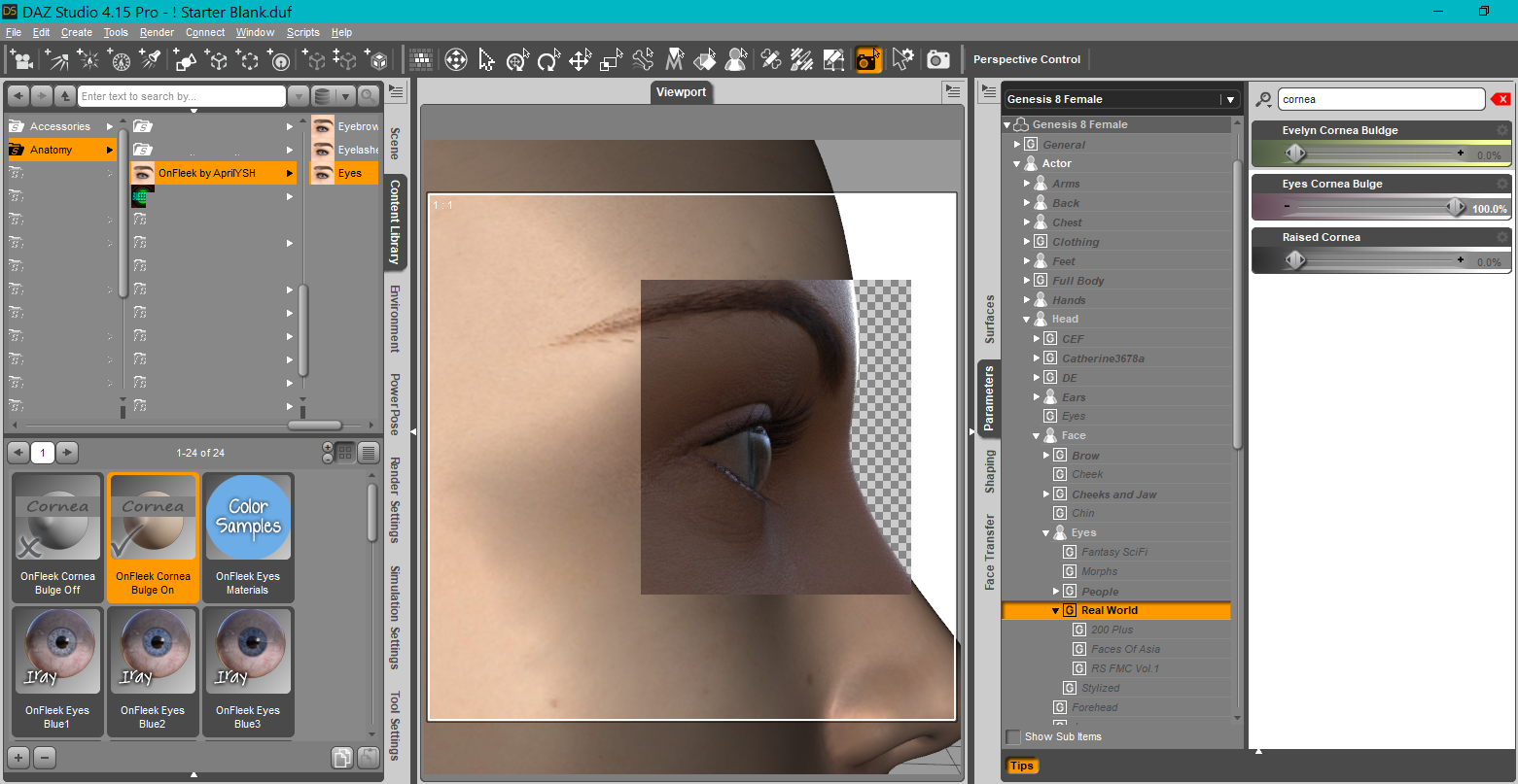

    Success!
    Okay :-)
    On the Parameters Tab look here:  Actor/Head/Face/Eyes/Real World
    You might have "Eyes Cornea Bulge"
    This morph is activated by the Shape preset "OnFleek Cornea Bulge On" which is free here: https://shop.aprilsvanity.com/onfleek-for-genesis-3-8-female-s.html
    To download, click the "Download for Genesis 8 Female" at the bottom of the product description.
    1561 x 807 - 584K
    Post edited by Catherine3678ab on
