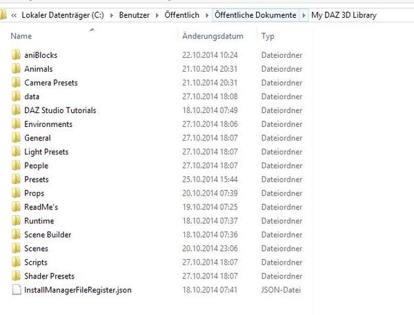

    The way that the path is listed in Content Directory Manager is important. It is also important where the Runtime folder is in relation to the other folders. What I mean by that, is that the folder called 'Runtime' that DS uses for Poser Format content, MUST be directly inside the main DS folder 'My DAZ 3D Library' or 'My Library' if you use that.
    Whatever folder you use for DS and Poser content, it should be listed correctly, and the path should finish with the library name, whether for DS OR Poser content as shown below.
    C:\Users\Public\Documents\My DAZ 3D Library
    Inside 'My DAZ 3D Library' (or 'My Library' if you use that), should be the Runtime folder. The Runtime folder should NOT be inside yet another folder called Content, and the path should NOT include the Runtime folder.
    It would be most helpful if you could post a screenshot of your Content Directory Manager settings showing an expanded listeing of your paths for both DS and Poser, just to make sure that they are correct.

    Hi Jimmy,
    thanks a lot for your post.
    I guess the path to my daz library is correct: see screenshot.
    Another thing: I purchased two products. But I do only see the female suits. Not "Just Posh". Where is he? Where is Posh?
    Best regards, JS
