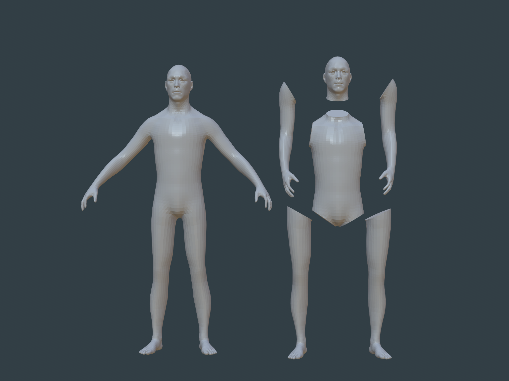

    You could look into Autodesk's MeshMixer... https://www.meshmixer.com/
    Its a free program people use for fixing or tweaking 3D models for printing... but you need to have a good closed mesh for it to work properly... otherwise it has lots of features for 3D printing.
    It has similar features to the iPad app (Nomad Sculpt) I used to cut up this figure... it's a quick and dirty example, and I'm not suggesting Nomad Sculpt for this purpose, but it has a feature that automatically closes the mesh when you cut it... or in this case separate a section... otherwise just separating a part of a mesh leaves it open or "hollow" inside.
    Further Edited To Add...
    I decided to mess around with the above figure in Nomad Sculpt... just to see what it would look like as a kit on runners (it's nowhere near accurately set up for injection molding)... But it was actually pretty easy to do, so if that's something you really want, I'm sure you could do it in MeshMixer too.
