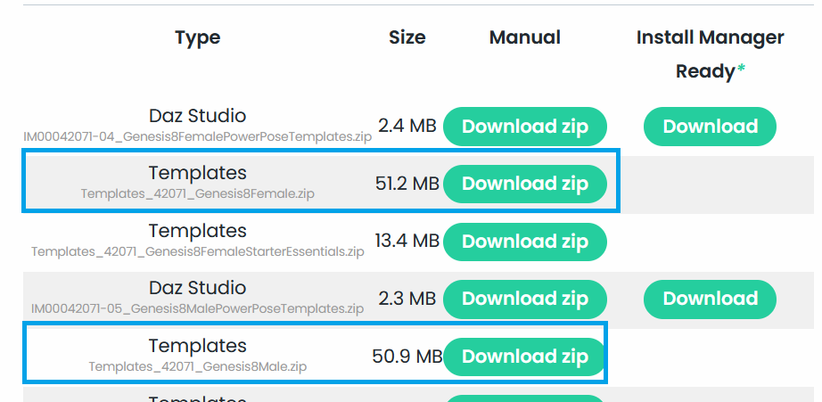

  • Have you tried using the templates?
    Could you elaborate? I'm not sure what you mean
  • In order to apply a texture to a model it has to go to the correct place, relatively, on the map. The templates show where those correct places are.
    As Richard mentioned, you need to put the new image to the correct placement on the area of the template that the desired mesh can read.
    You need to use an image editor that can work with layers. {G.I.M.P., Photoshop, PaintShopPro, etc.} And go over the borders a bit, applying the new textures over the seam allowance/buffer zone so that the seams do not show on the figure. {esp. for making skins}
    Templates are in your Product Library {Genesis 8 Starter} ... look for these:
    922 x 451 - 68K
    Post edited by Catherine3678ab on
