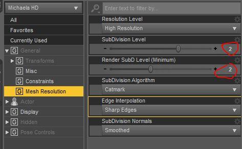

  • MelanieLMelanieL Posts: 7,746
    edited August 2021
    I believe that Richard means in the Parameters tab, under "Mesh Resolution" you should see this:
    473 x 292 - 33K

  • Db3dDb3d Posts: 248
    @MelanieL, I've done that.   I thought he was talking about in the Render Tab (one with the Camera icon).
    I've tried every setting, and my Viewport render looks perfect, but the render to a file has pokies.  :(
