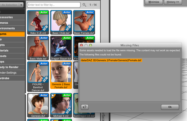

also when trying to load a figure i am getting the error message Some assets needed to load the file were missing. the content may not work as expected the following files could not be found
/data/DAZ 3D/Genesis/Base/Genesis.dsf
It seems that i dont have any file ending in .dsf? only in .duf?

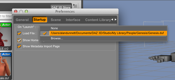

    That means you had DS4 installed before 4.5 - then the user-facing files were in .dsf format. Updating DS doesn't update settings, including the start-up scene. If you want Genesis to load on start up go to Apple menu (Mac)/Edit (Win)>Preferences and change the settings in the Start up tab - either use the ... button to choose the genesis .duf file, or simply choose none to have the scene load empty (or create a scene with your own preferred lights and content and make that the auto-load file).
  • aliendoughnutaliendoughnut Posts: 40
    I have changed the preferences startup as mentioned but am still getting the same error message about the dsf file?the preferences startup path does go the duf file but this hasn't solved the issue also when trying to load figures still getting the message about dsf files missing

    yes the startup path is to the .duf but is still asking for the .dsf file i did have the previous version of daz studio installed when i uninstalled is there a chance some files were left and this is causing the issue? if so would the best course of action to try to uninstall again? and how can i be sure i have not missed any files?

    Can you post a screenshot of the error message?
    seems like it is looking for .dsf files?

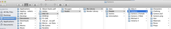

    this is where the folder is located

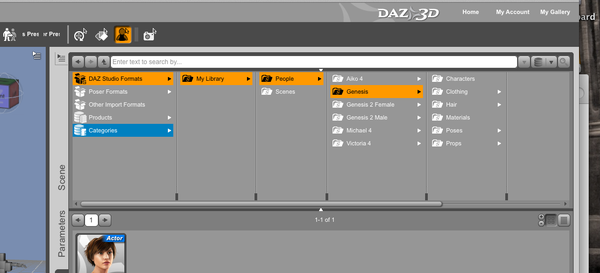

    It's the \Data\DAZ 3D\Genesis\Base folder I am asking about. Assuming it's in the Data folder in your screenshot, is that My Library folder set as a DAZ Studio content directory in DS? Does it appear immediately under DAZ Studio Formats in the Content Library pane?
    snapshot of the content library pane

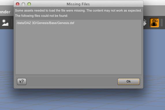

    i'm about ready to give up :down: iv tried everything from uninstalling and reinstalling but the problem is the files (figures etc) i try to load always ask for a .dsf file is there a way round this so it looks for .duf files?

  • Richard HaseltineRichard Haseltine Posts: 108,608
    The .dsf file is called on by the .duf file - that's why the path in the error message is different from the path to the file you are loading. That's why we are asking where the /Data/DAZ 3D/Genesis/Base/Genesis.dsf file is on your system, and whether the folder that contains the Data folder is selected as a DAZ Studio Format content directory.

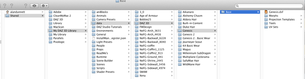

    ok after searching i have found the folder which contains the .dsf files( /Data/DAZ 3D/Genesis/Base/Genesis.dsf file) see attached pic!! seems it is located in my shared folder? and the DAZ Studio Format content directory does not point to this folder
    so the question is are these file used by daz 4.5 i understand .duf files are used but i could be wrong and what should i do next as i have this and the installed folder which contains the .duf files. do i need both?
    Open the Content Library pane, right-click on DAZ Studio Formats (control-click with a 1-button mouse) and select Add new Base Directory. In the dialogue that opens select the /Shared/My DAZ 3D Library folder. This is the default content location for the DAZ Install Manager - there are good reasons to keep it separate from the folder for non-DIM installs.
    All working now!!! :-) just a case of pointing it in the right direction;-)
