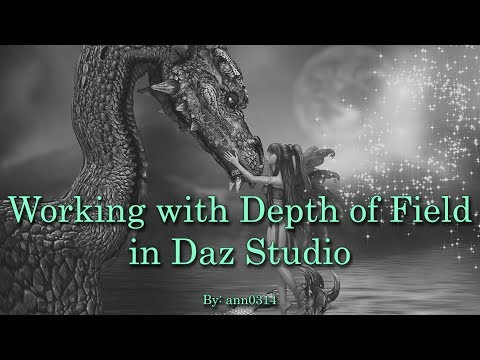

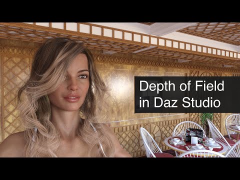

    Here is a couple tutorials for DOF in Studio just posted 4 months ago and the other 2 months it should be current version of DS
    Post edited by frank0314 on

    Here is one my wife did that goes over all the settings and setting up DOF
  • Thank you for those. I saw the first two before and it's not that I can't get DoF specifically work. With 'hacky' numbers everything works. My question was about Iray in Daz and the disconnect to real world values. And I guess my question was 'WTH am I doing wrong?' in case it's a user error, which is quite possible.
