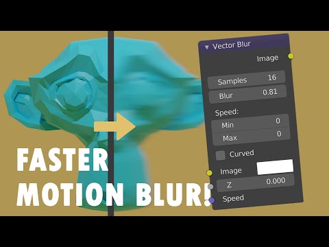

Now i have been using Blender for quite some time and am quite familiar with the compositor, there is this amazing node that can take a completed render, and use the existing color data to add some amazing looking motion blur outside the render engine. Basically you create a simple animation but you render only a single frame, you will have to check a box to make sure the render also calculates the vector data based on the animation you created. In the compositer where one can edit the image, they can pull up a node and add the vector data so image processing will add motion blur in post.
Its not perfect, but its pretty amazing, now if someone can make a plugin for DazStudio that applies the same principle it would change the way renders look, i myself would be using it all the time. If only there was a way to export vector data from a Daz Studio render into Blender compositor would actually suffice for me.

See this video how simple and fast motion blur can be added to a single image, thats what the program needs.
