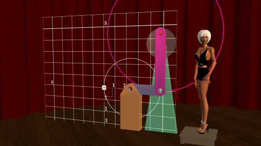

  • mCasualmCasual Posts: 4,607
    edited September 2014
    the source code for now
    the final version will adapt to other configurations
    mcjKeepOrientation
    was used to keep the rod connecting the 3 wheels horizontal
    that connecting rod is parented to the master wheel
    mcjKeepOrientation was also used to keep the piston horizontal
    the piston is parented to the push-rod
    the push-rod is parented to the master wheel
    before running this script i selected
    1 - the push-Rod
    2 - the piston
    3 - the cylinder
    the slave wheels copy the master wheel rotation
    i locked their translations then copy-pasted the master wheel X rotation
    tick = Scene.getTimeStep();
    pushrod = Scene.getSelectedNode( 0 );
    piston = Scene.getSelectedNode( 1 );
    cylinder = Scene.getSelectedNode( 2 );
    pistonPos = piston.getWSPos( 0 );
    pushrodPos = pushrod.getWSPos( 0 );
    pushrodLen = pistonPos.subtract( pushrodPos ).length();
    vz = DzVec3( 0, 0, 1 );
    for( fr = 0; fr < 31; fr++ )
     t = fr * tick;
     pushrodPos = pushrod.getWSPos( t );
     pushrodPos.x = 0
     cylinderPos = cylinder.getWSPos( t );
     cylinderPos.x = 0
     cylinderAxis = cylinder.getWSRot( t ).getZAxis();
     pushrodAxis = pushrodPos.subtract( cylinderPos );
     hyp = pushrodAxis.length();
     v = pushrodAxis.cross( cylinderAxis );
     opp = v.x;
     cosang = opp / pushrodLen
     ang = Math.acos( cosang );
     if( fr == 0 )
      zeroang = ang;
     else
      ang = ang - zeroang;
      v = new DzVec3( 0, Math.sin( ang ), Math.cos( ang ) )
      r = vz.getRotationTo( v )
      pushrod.setWSRot( t, r );
    1920 x 1080 - 929K
    Post edited by mCasual on

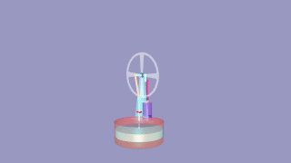

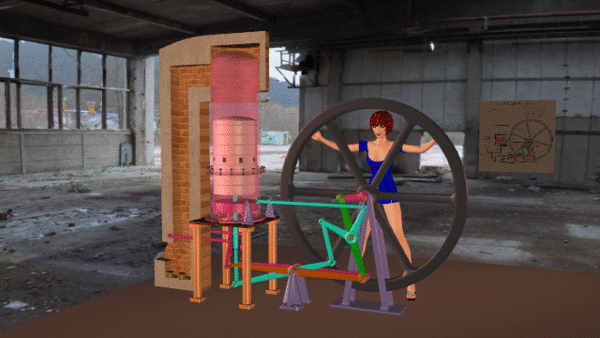

    Amy inspecting a Sterling engine ( hot/cold air based )
    1920 x 1080 - 554K

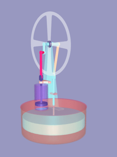

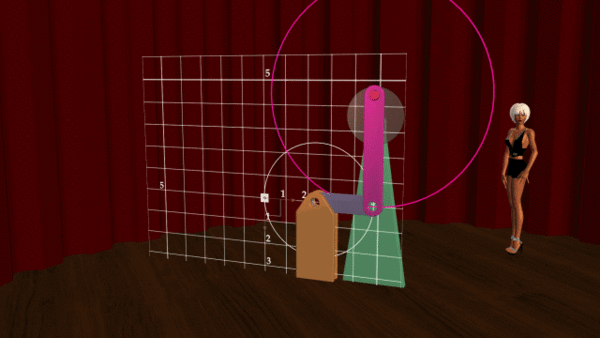

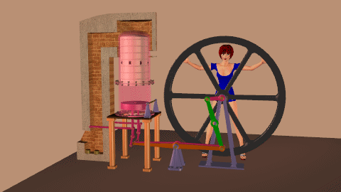

    the displacer mechanism of a Sterling engine
    note that this design is absolutely not guaranteed to work in real life
    but it's the general configuration for a Sterling engine
    the displacer pushrod will be parented to the flyWheel
    the displacer will be parented to the displacer pushrod
    the script will keep the displacer sliding up and down along the Y Axis of the displacerGuide
    this is achieved by rotating the displacer pushrod and the displacer around their respective X Axis
    Figure 2 , your sole task is to animate the wheel rotation
    Figure 3, there ya go i was able to make it work for Y-Axis piston action
    i just have to make it work for any configuration, including , in movement !, for example, a train climbing hills, and following curvy paths
    480 x 640 - 783K
    320 x 180 - 93K
    1030 x 960 - 60K

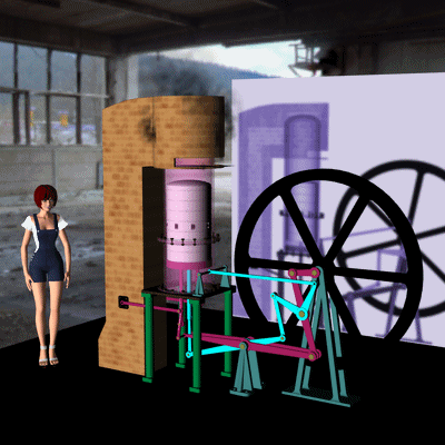

    4 important states of a Sterling engine

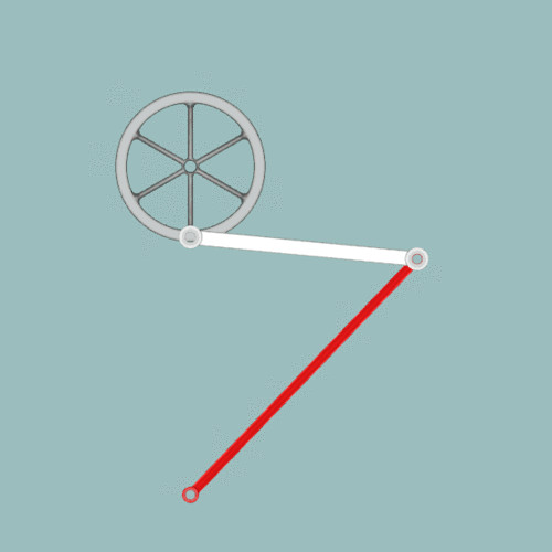

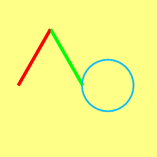

    the script will probably be called mcjArticulate
    and is probably best described as a planar mechanism solver
    figure 2 - it can also be seen as a case of two coupled wheels
    fig 3 it boils down to a triangle
    fig4 2 solutions satisfy the constraints so we must chose the nearest from the previous frame pose
    1000 x 830 - 130K
    960 x 960 - 107K
    960 x 960 - 103K
    960 x 960 - 307K
    1280 x 720 - 145K

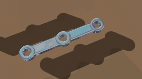

    edited October 2014
    pretty good song right there https://www.youtube.com/watch?v=1ny4XvhoMMc
    figure 2 - the L-Shaped morphable props ... coming soon ( which is way before never )
    1920 x 1080 - 781K
    1920 x 1080 - 695K

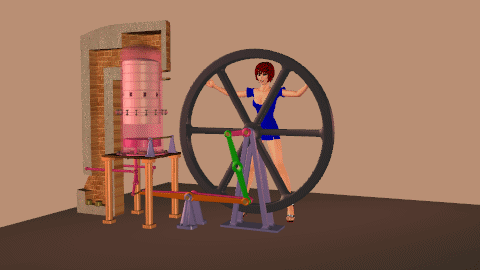

    getting closer to the ready-to-animate build
    the problem with the 1816 Stirling engine is that everyone ( and that's not a lot of people ) only show it in plan view
    Fig 2 - yes one of the arms in fig 1 would break, but in fig 2 it wont
    Fig 5 - so this was done in 4 script runs - the tedious part is positioning and parenting the "end" nodes
    ( using mcjMakeTarget and mcjParent ) )

    mcjMechAnim ( name was chosen )
    will have at least 4 tabs
    1 - a solver for 2 planar-rotation rods and a joint
    2 - a solver for a push-rod and a piston
    3 - a solver where you chose the endpoints of 2 rods
    the script will keep rodA pointing at rodB's origin
    4 - a utility that creates a null-node at the center of a circle
    this circle is computed based on 3 points
    the 3 points are the positions of a node of your choice at the
    beginning, midpoint and endpoint of the animation playrange
    Fig. 1 shows an example of tab 4, i needed to find the center of rotation for a rod
    and tab 3 will be used to keep that rod oriented correctly
    the length of the rod is fixed and adjusted "manually" by me
    i'll probably "force" you to supply a primitive plane which tells the script
    the rotation plane for your machine, because that's what is is, a solver for planar mechanisms
    if your machine is aboard a train, that plane must be aboard too !

    the "joint solver"
    basically finds the intersection of 2 circles
    after having projected the machine onto the machine's "plane" of action
    since there's 0, 1 or 2 solutions to this, i want to make sure the script chooses wisely
    in figure 3 a challenging test for the ''joint solver''
    since the large torus turns 5 times slower than the small torus, i was expecting 5 loops or something
    instead we got 4 blades
    note that the trace is courtesy of mcjTracer
    https://sites.google.com/site/mcasualsdazscripts/mcgtracepath-for-mcjtracer
    https://sites.google.com/site/mcasualsdazscripts2/mcjtracerv2
    the constant rotation speed is obtained using
    https://sites.google.com/site/mcasualsdazscripts/setinterpolation-for-ds2-3
    which is a pretty indispensable tool for animators by the way

    i'm adding the reach solver
    which is a bit like mcjAutoLimb
    you select a 'hand' node ( in this case a null node parented to the green "foreArm" cylinder )
    and you select a target node, in this case a null node parented to a rotating torus
    and the script will solve the elbow bend angle of the foreArm for each frame of the animation
    Fig 3 - the "reach" solver seems to be ready
    next is to re-implement the piston solver and make sure it can handle equivocal configurations

    configuration for the "piston solver" tests
    note that the origin of the piston is often in the middle of the piston cup
    Figure 2, the "Help" panel
    Figure 3 - The Piston Solver's good work

    ** Rush Release **** Rush Release **** Rush Release **** Rush Release **
    https://sites.google.com/site/mcasualsdazscripts5/mcjmechanim
    or you could call it a Beta'ish release
    Demonstration Videos :
    https://www.youtube.com/watch?v=QEwpUlsqDGI
    and
    https://www.youtube.com/watch?v=FhgCemjxEjA
