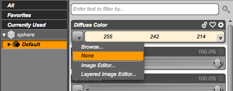

    In the surfaces tab remove the the texture from the diffuse color dial, and set the color to off white.
    It also appears items that rely on transparency maps should be removed and set the opacity to 0 so they will be invisible in the render, the eyelashes in this case.

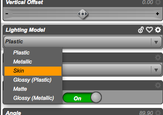

    Keep some gloss on the surface and you could probably just leave the Lighting Model parameter value where it was (usually it's skin for figures and plastic for everything else)

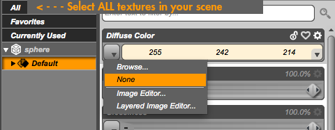

    You could also select everything in your surfaces tab:
    Surfaces tab, click on the button above the surfaces that says "All" and change the "multiple maps" in the diffuse color section to "none" and that will remove all textures from the scene.
    You can experiment with removing the bump and displacement maps the same way, or you may want to keep them for added realism, possibly keep the displacement and loose the bump, etc and see what turns out closer to what your trying to achieve.
