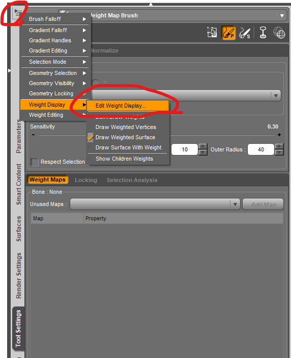

    The number of weight map colors and the colors themselves can be modified in the Tool Settings pane. These are the default values, I believe.
    Thank you for the reply, Barbuilt. You've showed me the way to modify colors, but it does not explain the purpose of the yellow color.

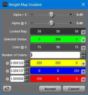

    In the colors screehshot I posted, you can see that yellow has a weight slightly lower than blue.Neither one is zero. It shows color at weight 0 as gray. I have no idea why it is configured that way.
    Got it! Thanks, barbult !  smileyyesyes

  • Richard HaseltineRichard Haseltine Posts: 108,485
    Sorry, I was misremembering.
    barbult I would think the idea is to be able to see the weights that are near enough 0 so that they can be made exactly zero.
  • barbultbarbult Posts: 26,304
    Ah, that makes some sense!
