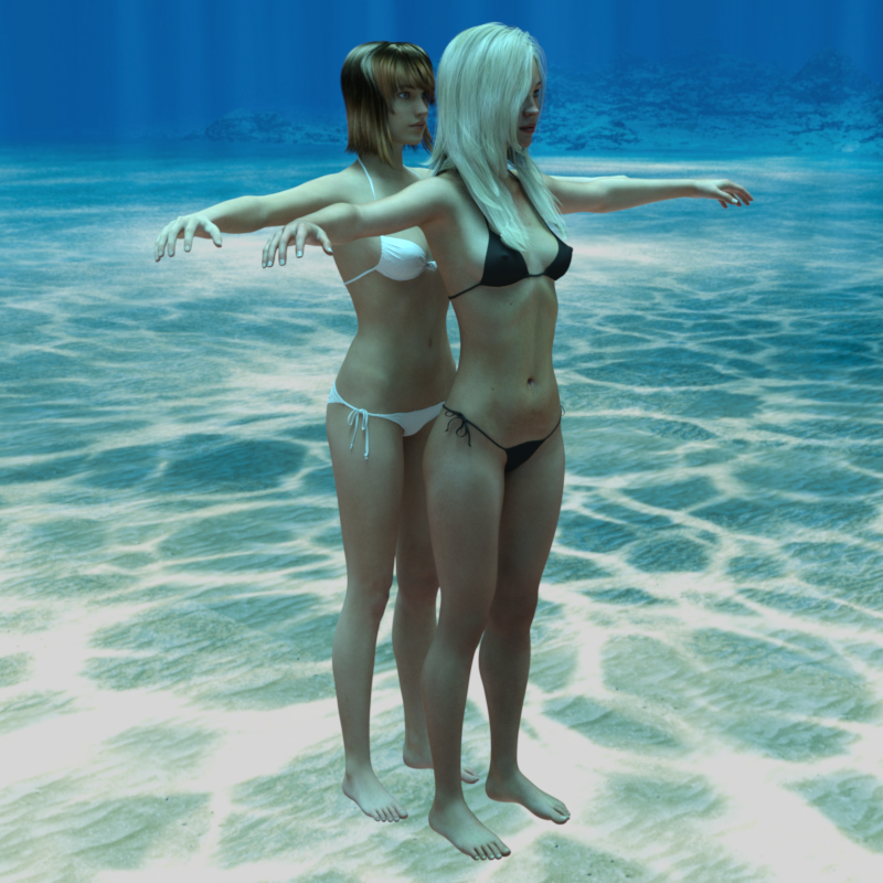

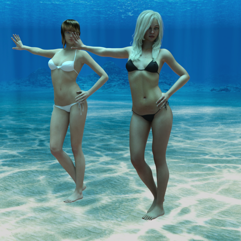

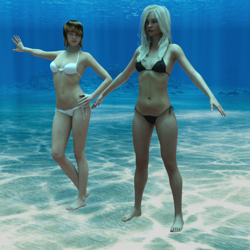

Below I show a number of images. The first is G8F showing the similarity of poses after the zero pose transfer, the second shows a G1 base pose applied to V5 while G8F is in her zero pose, and transferred to G8F in the third. Hope the script is of some use to someone.
One thing that surprised me is the way on the shins how a 90 degree bend on G1F needs a 94 degree bend on G8F, and a 4 degree reverse bend on the foot to get the global angle of the sole the same. Took a little time to get my head around that. As usual, the G8F +ve direction for the eyes up-down and side-side is the opposite of the earlier character, all catered for in the transfer.
Characters: G1F is Victoria 5. G8F is MostDigitaCreations 'ACJenny for G3F and G8F' applied to G8F.
