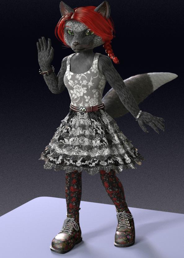

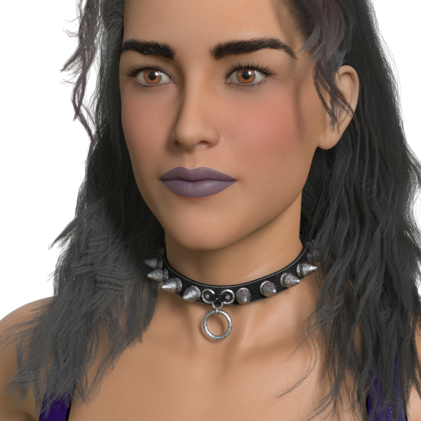

    So, this DM Folly set is going to need a proper upscale displacement map because the normal map supplied doesn't cut it for me... and we're talking vector displacement here. In theory, it should be possible to eliminate the "fissure" artefacts along the edges.
    And this is Stephanie 8, whose makeup textures have rather sloppy alpha channels (( It's not noticeable when you simply look at the file in IrfanView, but once you open GIMP and want to save out the alpha to use in the overlay diffuse of your shader... well, alright, just one more reason to paint my own makeups.
    Here I used a Xmas freebie by Cherubit for the eyeliner and blush masks.
    What's awesome is that we have SSS maps here that are lightened diffuse maps. I love this. It allows me to turn off this operation in my shader. And if I want a paler Steph, I can just load those SSS maps into diffuse.
    The Rocker Choker needs its (iray-optimised) bump map dialed down even further. The Delta Corset default textures also need to be looked at and probably completely swapped for tiled maps - I want it to look like leather. It wasn't probably intended to.
    Now, hair. It's dForce Volta hair, and - and it's the sort of hair I've wanted to see in DS since I got into this hobby 3D thing all those years ago. I use the 3Delight hair BRDF, and just how fast it renders, I want to weep for joy... And just how amazing it looks!
    I honestly don't know what I'm going to do with my collection of transmapped hair. Maybe they might render in a reasonable time in something like Marmoset. Hopefully. I just know I don't want to use them in DS anymore. ...not even talking about how stiff they look most of the time!

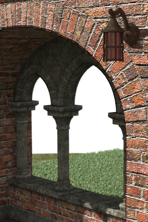

    Awwwkay, so that original diffuse map is basically a lost cause when it comes to filters - the values are all over the place due to the way the photos were taken (the bricks are often darker than the mortar, eh). Trying to reconstruct the proper mortar depth using edge detection would take too much time, and I don't even want to get started on painting it manually. It's just not worth it.
    Moreover... the artefacts appearing at the edges when displacement is enabled are due to geometry, and they aren't really going anywhere. See how it looks with a texture set from TextureHaven... kinda sad. And of course silly, because brick arches don't work like that IRL.
    Replacing bricks with a more uniform material that does not require displacement kinda works, but a) looks boring; b) makes the faceted geometry way more evident.
    So I gotta catalogue this Folly set as an item to be used strictly for one-off portraits with heavy DoF or in long shots. Oh well.

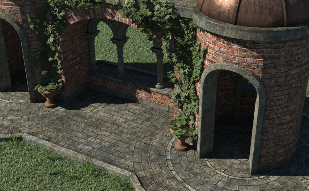

    So here are them default maps, no vector displacement whatsoever, with ivy - transmapped ivy, which casts GI shadows, eating at rendertime but looking much more realistic than without this one diffuse bounce. 6 min 47 s on an i9-9880H.
    Sweet, eh? Shame it doesn't work that way in closeups ((
    // click for full-size //
    ...the grass is this, BTW: https://erock3d.com/download/erock3d-free-grass-system/
    and those other images are the same as in the previous post, the forum is wonky still/again, I guess

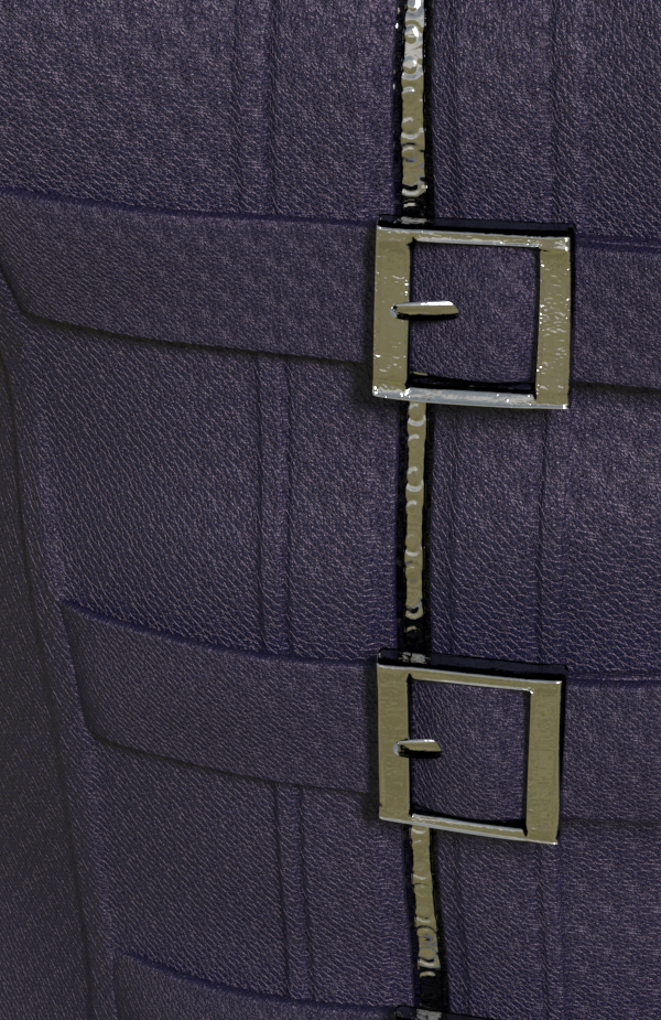

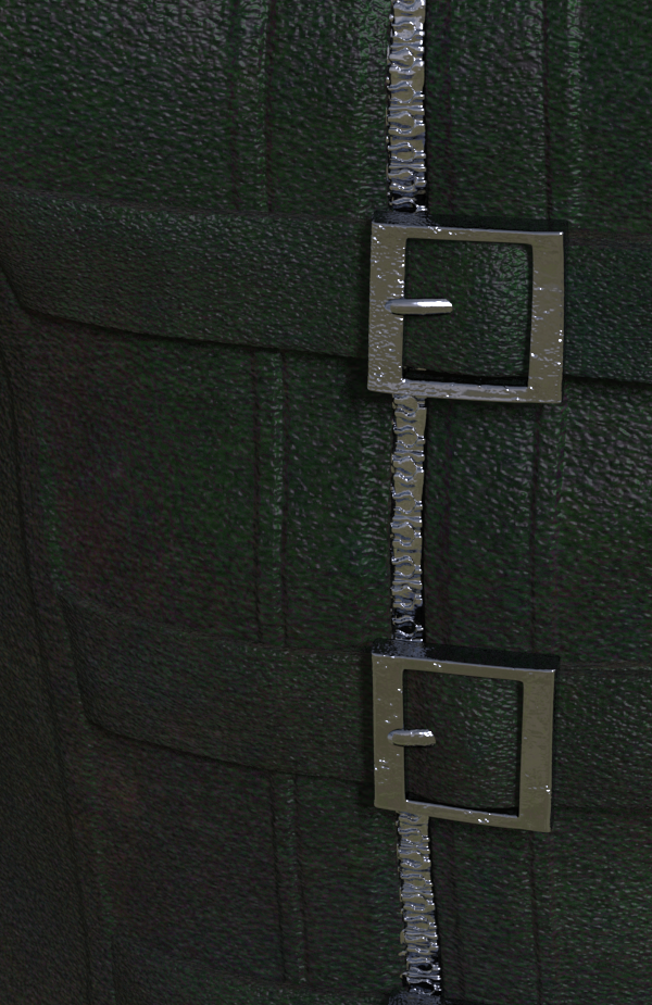

    ...and now, Delta corset. Talk about weird control maps and weird other things.
    // click for full size //
    The leather tile is clearly too tile-y, making for that rhomboid pattern, so I'll try another one.
    But. There's a neat zipper on the height map of the corset. And there's a mat zone that is located at approx the same position as the zipper. So I thought that despite the zone being named "Top", it should neatly house the zipper.
    Well, apparently not. Looks like that in order to get that cute zipper to show up properly, I'd need to either widen the "Top" mat zone or use the provided metallicity map over the remaining corset surface... and this map is kinda wonky actually. Here's a scaled down screenshot:

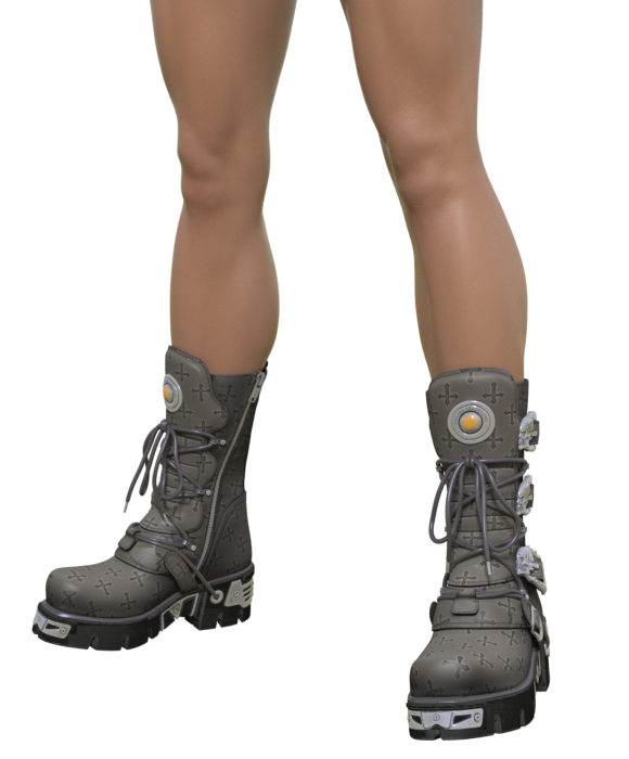

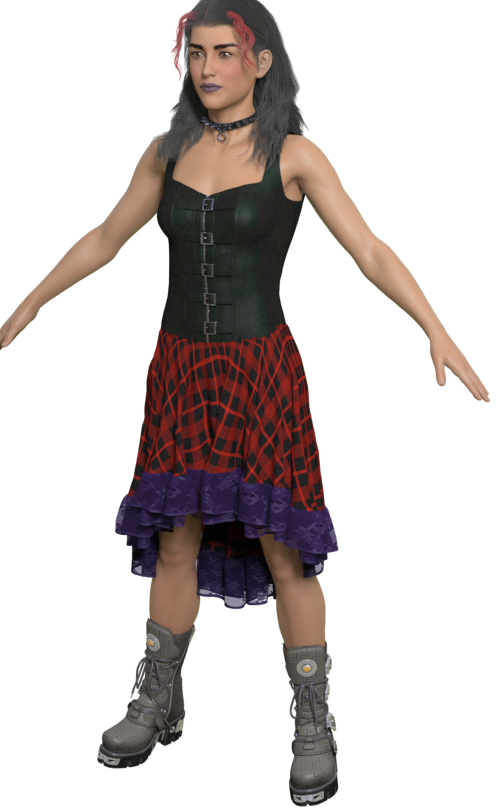

    Back to Steph and the outfit I'm trying to kitbash.
    I've ultimately decided to go with a paler Steph because this trademark "DAZ orange" skin doesn't really look "natural" to me, given that I come from a different general culture and from a different subculture, to boot.
    The zipper of the Delta corset, well, I studied everything closely again and found out that the mat zone is perfectly fine, but the zipper itself is kinda... broken: every other little prong (or whatever it's called) appears to be "divided in half", on both the height and the normal maps. Somehow using the height map for displacement creates these weird darkened zones that made me believe the mat zone is off... so I went with the normal map and vector displacement.
    Not really perfect, as you can see, but should in theory work when not a closeup. I hope.
    The skirt is again retextured, but the boots are very much as-is. They don't have mat zones, everything is done via maps. Love this New Rock-style sole, modeled authentically and beautifully.
    The items haven't yet been fitted to each other, the hair isn't simmed, and I think the colours need work. The green-ish tint of the corset is due to thin film, and I like it a lot, so I guess the other colours will be built around this. Probably a different texture set for the boots should be used for a better match.
    Leather tiles for the corset from old Calida3D shader presets (not sure if those are available anywhere after the site went down), tartan colour and bump for the skirt from RedEyeCat's holiday materials freebie (which I can't seem to find...); and here are the links to the store items I'm using:
    https://www.daz3d.com/volta-hair-and-beard-for-genesis-8
    https://www.daz3d.com/rocker-outfit-for-genesis-3-female-s-and-genesis-8-female-s
    https://www.daz3d.com/delta-outfit-for-genesis-8-females
    https://www.daz3d.com/dforce-vernea-fae-outfit-for-genesis-8-females
    https://www.daz3d.com/sw-boots-for-genesis-8

    My next plan is to build a "nature" shader on the basis of my RadiumFabric, which is the kind of shader that supports basically "everything outside SSS". So I will need to add various (mostly noise-based) procedural augmentations to the colours mainly, with switches to use the same patterns to enhance relief when it makes sense.
    First, I want to add colour randomising based upon the original texture (or a solid diffuse colour).
    On older hardware, transforms between colour spaces used to be costly, but they may not be so much of a factor anymore - and controlling the randomness per hue/saturation/value makes more sense from the artistic PoV than implementing randomness in RGB channels.
    Then, I'll need to figure out how to control the "spread" of randomised colours - right now I'm thinking of mixing the original texture with the randomised colour via a noise-driven mask. But there may also be a way to tint, say, every leaf of a tree slightly different, even though they're all the same material. We'll see how the randomiser function can be seeded.
    Then, I want a multilayered combo of slope- and altitude-driven tiled textures and procedural colours, which could be used for faraway landscapes, wet stones etc.
    So everything boils down to finding good sources on writing noise-based patterns and proper antialiasing of that code. Which I will also use for my atmosphere shader. This is math, and I was trained to be a research engineer not a mathematician... not my favourite part of coding, to put it mildly, because I don't understand much about math as art.
    640 x 640 - 189K
    640 x 640 - 179K
    640 x 640 - 76K
    640 x 640 - 56K

    Trying to frankenstein Laura 3's head onto G3F with the V3 UV addon. I removed the geografts to try and see if it can be done by merging their necks... nope, unless you're really going for a Frankenstein's creation look. Guess I'll need to try the head-only way...
    Look at the ears. I like Laura 3 ear geometry much more. No "translucency strength" maps here or other tricks, just proper SSS.
    500 x 750 - 341K
    500 x 750 - 367K
  • Mustakettu85Mustakettu85 Posts: 2,933
    ...finetuned reflection roughness while I'm at it...
    Well, this is probably the best frankenversion I can muster... might work in a limited selection of poses/angles. Can't get over the fact how scarily realistic the seam looks, without any effort.
    I was hoping there might be an easy way to transplant my old Gen3 faves onto this V3-enabled G3F; alas. Will have to approximate morphs by dials and finetune in Silo.
    523 x 553 - 164K
    500 x 750 - 343K

    Escapism, they say. Having fun, they say.
    Like... erm... fun.
    So I did buy this Beowulf suit for M3, by Uzilite, since it was among the "PC for a day" selection a few days ago. In theory, M3 (a subdivided M3 RR, in this particular case) is still usable - although not for closeups because of the eyelids, eyelashes and eyebrows; M3 Hi-Res skin is still one of my favourite male skins evah (outside of that hairy chest, of course); I even seemed to find a sweet spot for the smoothing modifier... but then you start dressing the figure, and all hell breaks loose.
    Elleque's shoulder magnets are fine for the non-RR M3, but what I never managed to justify buying were M3 and V3 morph packs, so that's why I'm using the RR versions (that came with morphs built-in). RR's have a somewhat different zoning, so the mags are wonky. And we get those infamous round shoulders full-blast as a result.
    Then, I always see texture stretching - like above the top lip, or, again, on the shoulders.
    And actual poses look laughable - and what's that with the bottom of the pants? I keep seeing that. Always needs re-rigging, taking the bottoms out of the "feet".
    The question is, will it survive dForcing? No-one knows.
    I'll try next time I have a chance to use DS. Don't know when. Too much work.
    667 x 1000 - 294K
    640 x 800 - 636K
