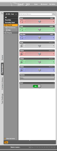

    edited September 2014
    As I said, nothing really there:

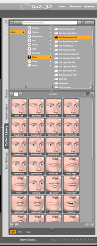

  • ShawnBoothShawnBooth Posts: 465
    I'm attempting to use these:

  • kaotkblisskaotkbliss Posts: 2,918
    See how you have "General" selected under the "currently used"? what happens if you move down and select "Display"?
  • fixmypcmikefixmypcmike Posts: 19,709
    Do you have Michael 3 or Michael 3 Blank loaded? The Blank version has no morph channels.
    (slaps forehead) I have the blank loaded...
    Will fix tonight.
