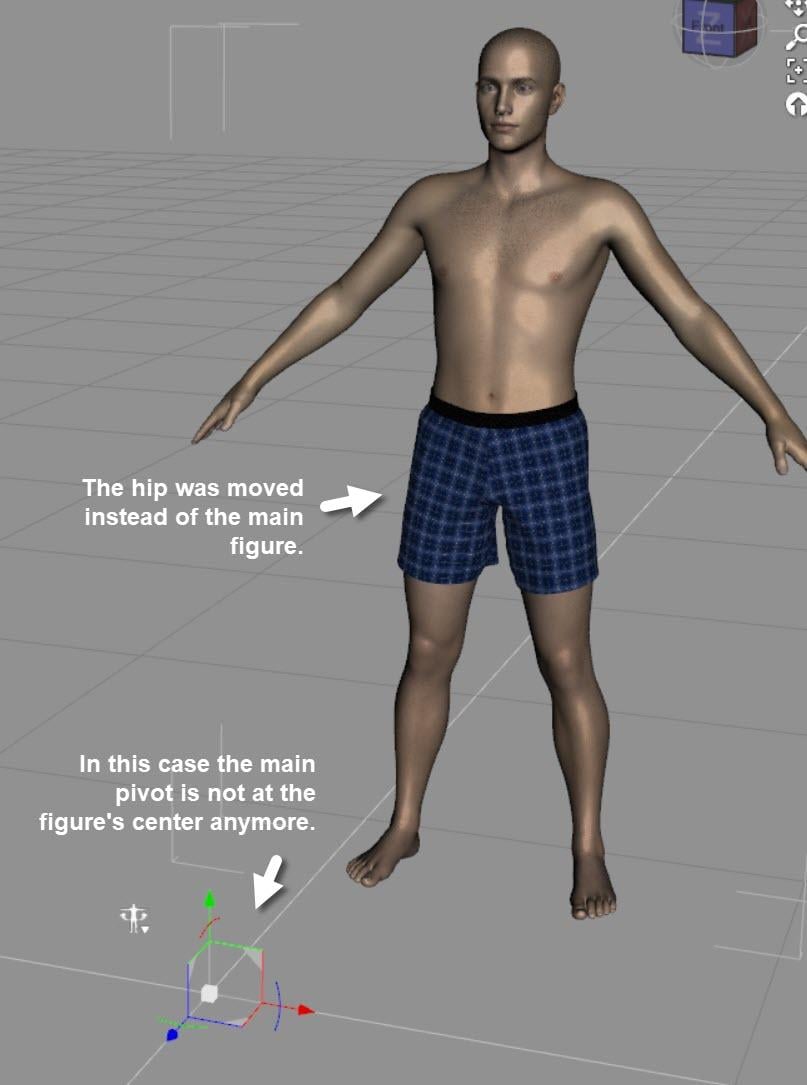

The pivot center (= place where the Gizmo appears when the Figure (not a body part) is selected) of those is by default in the center between their feet.
If your gizmo is not at the feet then you probably have moved the position of the figure by translating the hip instead of the main figure. To fix this set the translation of the hip back to zero and move the main figure instead.
Another case is when the creator of the figure, prop etc. has decided to define the pivot center not at the center of the object itself. In that case you can create a NULL object:
Move the null to the position of your figure or vice versa where you want your center to be and then parent the figure to the null:
Now you can translate the null instead of the figure but the figure will follow.
