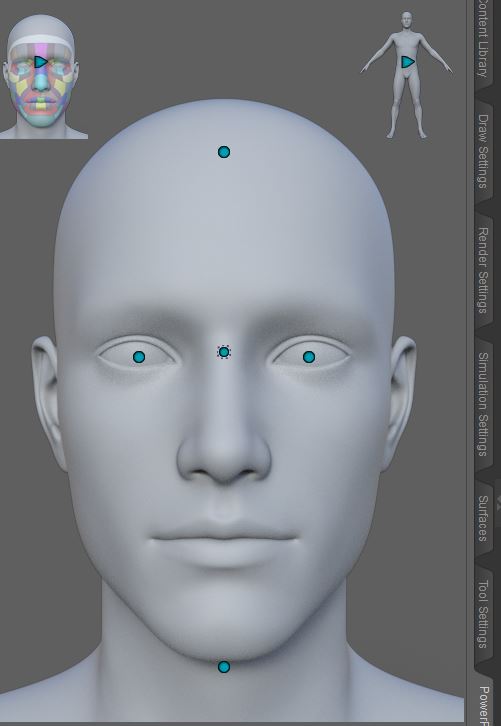

I've been trying out the Power Pose panel but I don't have as many points of manipulation on mine as in the tutorials and many of the nodes don't work or work correctly, are repeated or just random like the node for the right foot moves just the right foot big toe and the node for the left foot moves the right foot second toe. The face is missing all the nodes I see in the tutorials for creating expressions. It has only nodes for the eyes and the head tilt.

    I've got a delay for moderation or some such thing, as I'm new here I think, so I keep missing you guys. I managed to do a complete reinstall of Daz Studio. I got very lost for a while with the whole Daz central thing but I got it done and it took its time on the install, flashing lots of windows, some talking about repairing stuff. In Power Pose all the body and hand nodes are present and working perfectly. The head is still missing all the expression nodes with only nodes for moving the whole head or the eyes. Maybe they have been removed from the latest version for some reason?
    Do you guys have the expression nodes in Power Pose for the Head, for opening the mouth, lips making them frown and such?
    This is all I got...

    My Power Pose panel has 4 Templates: Body, Hands, Head, Face. Head is the one I've given a screenshot of, the one missing all the nodes. If I click that blue arrow it'll take me to the Face Template which has all the nodes and works as it should compared to tutorials and such online. As in PerttiA's attachment on their post.
