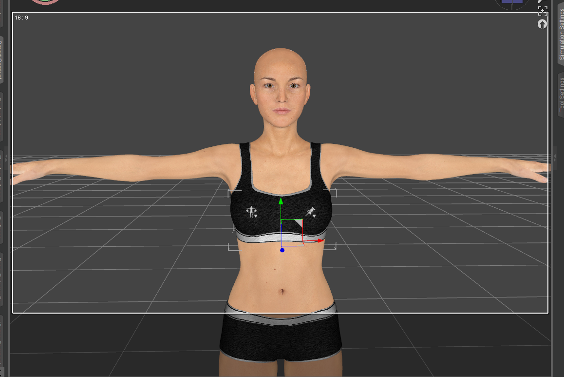

Hi all. I recently had my main computer shut down on me with windows 10 on it. I was forced to use my older computer with Windows 7 on it. I installed Daz 4.15 and 4.12 into it. I came here to my products list and downloaded some of my purchased stuff including Genesis 8 starter essintuals and head and body morphs. I got all I wanted and installed everything like I have for years. When I opened Daz and loaded the Genesis 8 female character, she came back looking like this. Her hip crest is way out there and her legs have no shape and her chest area is way to wide. Her face does not look anything like it does on my main computer. All genesis 8 female characters I load that use her have this problem. The faces don't look anything like they are suppose to. I know Daz released a Genesis 8.1 that comes with the download and installs with her. Could this be causing her to look so pitiful? I hate her look now. Is everybody having this same look or is something wrong with mine? I downloaded the set two times and installed it. No change. Those hips are horrific! Even her basic wear bottoms don't fit. They are going into her stomach at the top.  My Genesis 3 female looks exactly the way she should. It is just Genesis 8 female. Can anyone tell me why this is? I am including a open GL render of her so you can see the difference in what she should look like! If this is the "New" Genesis 8 look, I don't think I will be useing her anymore. I have bought lots of characters for her here and they do not look like their promo pics. I will just go back to using Genesis 3. So sad.

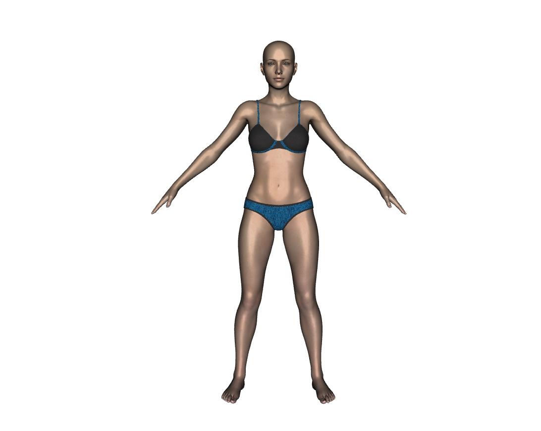

    Here is Genesis 3. She looks normal.

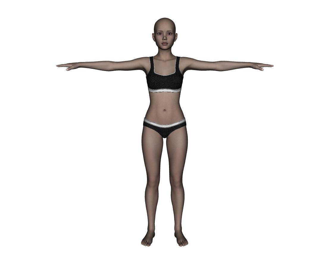

    For future reference, you can easily see if any morphs are dialed in by clicking on "currently used" at the top of the left side of parameters. It does sound like there is a morph that is loading with your figure (Some characters are accidentally sold with the morph set to load at 100% instead of zero. Once you find the culprit, you may want to submit a ticket), but I can't see the pic you uploaded of your G8 for some reason. If you don't see anything dialed in, maybe try unhiding hidden morphs by right-clicking on the parameter tab, going to preferences, and selecting "Show hidden properties."
    Also, your G3 doesn't look right to me. She has kind of a babyface and button nose there. The regular G3 looks a bit older and has a larger nose with a higher ridge. Your G3 also has a smaller waist.

    OK...I have found the culpit! It is a freebie character by Dream Escape called Erika! God knows where I got her from...lol. Her head and body morph dials are there and set to 100. When I slide them to zero I get Gen 8  back to normal. I tried to delete the morph dials and they came back when I reopened Gen 8 basic character. So I went after the character itself. Characters come in three parts. Data,People and runtime. I went to people first and found the character folder which has the .duf file and deleted the folder. I couldn't see going after the runtime folder because it contains only the textures for her and they do not come into play here. So, I went after the Data files. I found her under data>Daz 3D>Genesis 8>Female>morphs>Dream Escape>Erika. I deleted that folder so it could not find her morphs anymore. It worked!!!!!!!!!!!!!!!!! The dials are gone and the morphs are gone. Any of you out there who want to make note of this proceedure, you can because you may need it someday. Get rid of the morph data and it will fix Genesis 8 female basic. I went through all kinds of editing of paremeter dial settings first and it always came back. Then I realized I needed to go after the "cause" of the problem....morphs...data! Here she is back to normal.
