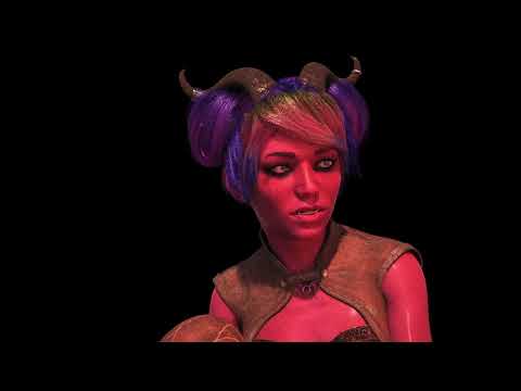

    Here's the partial results of my first test, a teenage tiefling girl talking to herself. Rendered with very few iterations to try to get the frames quickly, so it's grainy.
    Excited to keep experimenting.

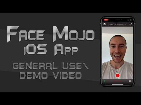

    I just uploaded a demo/general use video for the Face Mojo iOS app. Check it out:

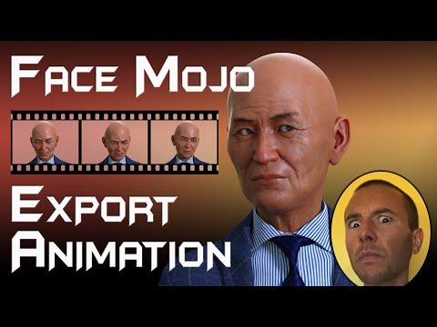

    I have this video that shows how to export the Face Mojo animation on a character out of Daz Studio via FBX:
    Does that process work to then take to UE for rendering?
    Yep-- I watched all of your videos. I even downloaded that FBX export script from your website.
    Are you ready for THIS frustration? I actually got the Face Mojo animation to work in Unreal Engine! I managed to do it twice successfully! NOW, however...it doesn't work(!).
    From what I have researched, it seems as if UE requires facial mocap data capture imported as FBX2011 (it's how the ROKOKO face mocap works). When I import the animation into UE, more often than not I get ALL of the morph targets, but NONE of the animation (except for head movement, oddly enough). I've made so many attempts that I think I confused my notes a bit, and now I am having a difficult time determining the path that enabled me to play the Face Mojo animation in UE. Luckily, I make new UE files for every experiment, so I will be able to backtrack to see how to make this work consistently!
    I feel like I am SO CLOSE! If there is ANYONE that has insight into this, it would be GREATLY appreciated!
