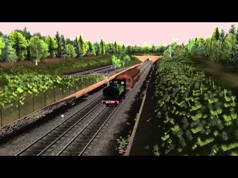

    By the way, I did a smoke simulation with the same train model:
    https://youtu.be/5pFzASNiCNo
