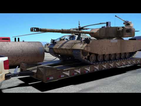

Hey Guys - I can't seem to find any info indicating a car rigged up in Daz3D can be used in Unreal Engine.  Assuming it can, I'm guessing I need to take a crash course in car assembly hierarchy found here https://www.daz3d.com/car-animation--daz-studio-iray-video-tutorial ; as I can't find other guides.  I presume bringing in a car into UE4 without the proper assembly structure is why wheels and other parts wander off.
Back in 2019, I posted a thread explaining that my boss saw an UE4 demo and decided I should abandon Daz3D and work exclusively in Unreal.  I had to explain to him you still need to use software to rig up assets to be used in Unreal.  I guess if the company used only assets that can be purchased within UE, I could use Unreal only.  But many of the props I use are automotive parts I create using Seimens NX12.
Turns out my bosses boss saw a UE demo a few weeks ago and insisted we need to start using UE.   The time it takes for me to create an engineering storyboard video used to secure funding from corporate headquarters for a new project just keeps taking longer and longer.  It took me about an hour to set this scene up using Daz with just using parenting (the background is an 8K image).  Can't imagine how much longer it will take once UE4 is added to the workflow and all the extra steps that must be taken.
