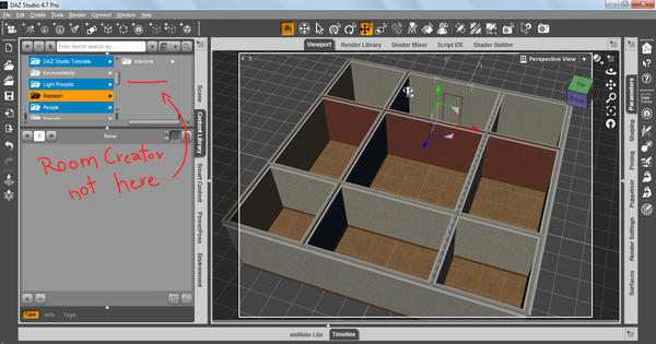

    Hi Maclean!
    Thanks for the answer. I am using Daz Studio and I am not using the RC Toolbar.
    I followed your instructions, but in Daz Studio/Maclean there's no Room creator, only folders to other products of yours (Attached screenshot). I searched everywhere in the DAZ Studio formats and Poser Formats of the Content Library. I used the search field and couldn't find anything. I looked in the documents folder and the only thing that I believe might be related is a RCQuickpose.py that I found in C:\...\DAZ 3D\Studio\My Library\Runtime\Python\poserScripts\ScriptsMenu .

  • macleanmaclean Posts: 2,438
    I think what may have happened is that you only downloaded the Poser version. There are 2 installers, and one has all the Daz Studio files. That seems to be the one you're missing. Poser has it's own version of the Toolbar, but of course, the .py files won't work in DS.
    It should still be in your account. Check and see, then let me know.
    mac
  • vithoralbertimvithoralbertim Posts: 8
    Thanks Maclean! That solved the situation.
    There was a 1 mega file that I ignored when I downloaded the RC2. I assumed that it was something for poser that I wouldn't need. I downloaded and copied the files to Daz and everything is working fine now.
