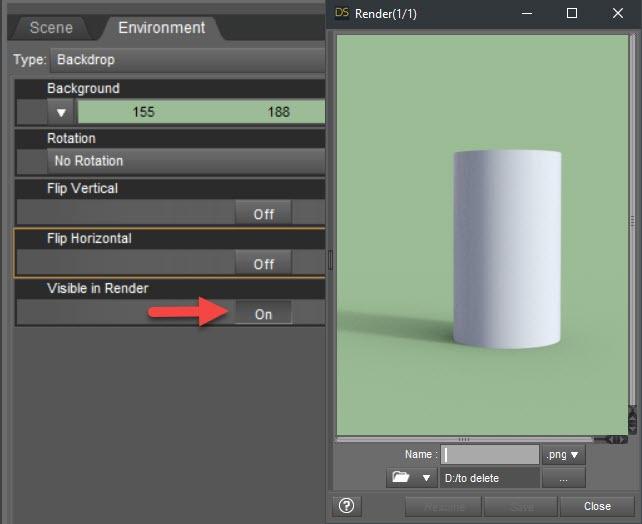

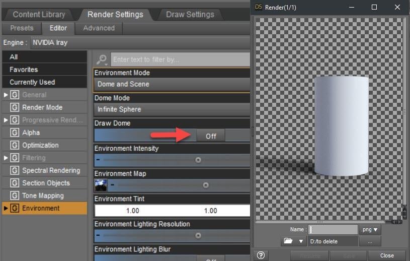

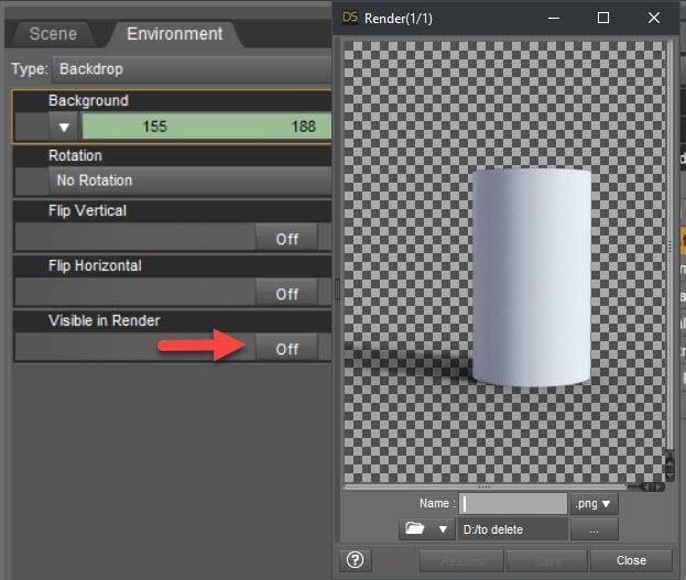

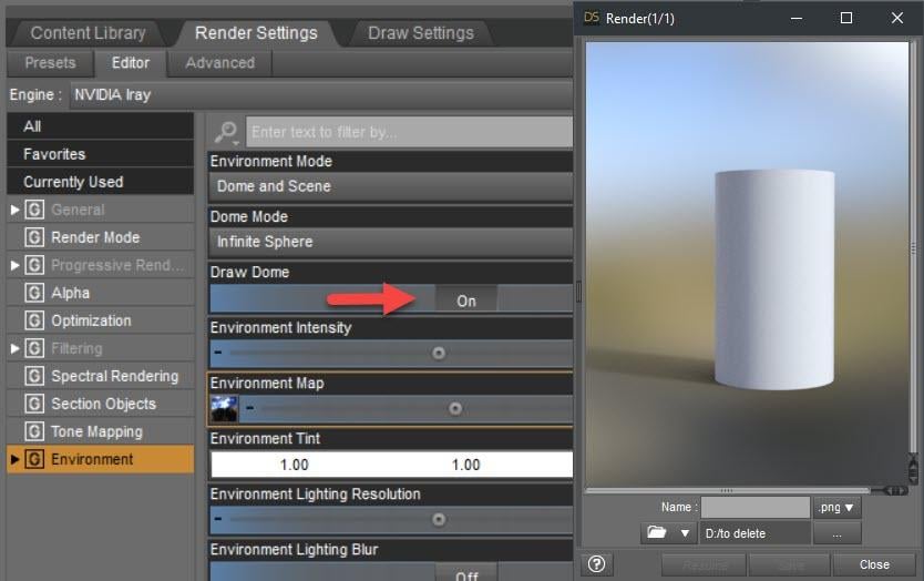

    There are two places where backgound can be set.
    The environment tab -> it creates a solid colored background
    The environment area of render settings (and scene node in newer DAZ versions) -> uses an env sphere image and adds that as light source.
    Depending on how you combine those settings you get different backgrounds in the render.
