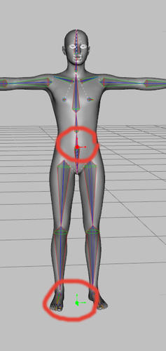

I 'Autodesk Maya' program with, to export. Daz Studio, looks this kind of. What is this problem? How can we solve?
Picture : http://i.hizliresim.com/pvPBXL.jpg
I'm waiting for help.

Not the problem or texture. The problem, as in the picture. Please see. There is a problem, position. http://i.hizliresim.com/pvPBXL.jpg
I have edited my character. 'Maya' with the program. When I re-import, that happens problem.
My : http://i.hizliresim.com/pvPBXL.jpg

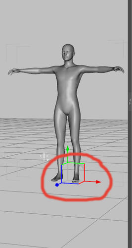

This should be : http://i.hizliresim.com/Z2d700.png

It looks like your centre axis is in the wrong place, a long way beneath the figure.
There is a way of moving it in DAZ Studio, using the Joint Editor Tool. Go to Tools > Joint Editor (Alt+Shift+J) and you will have to move each of the axis up to the correct position at the feet of Genesis. It must have got moved in Maya.

This is what it should look like. You could load a new copy of Genesis, and copy that?
Solved.
1 : (Assets > Transfer Utility)
2 : (Source : Genesis - Target : My Character)
