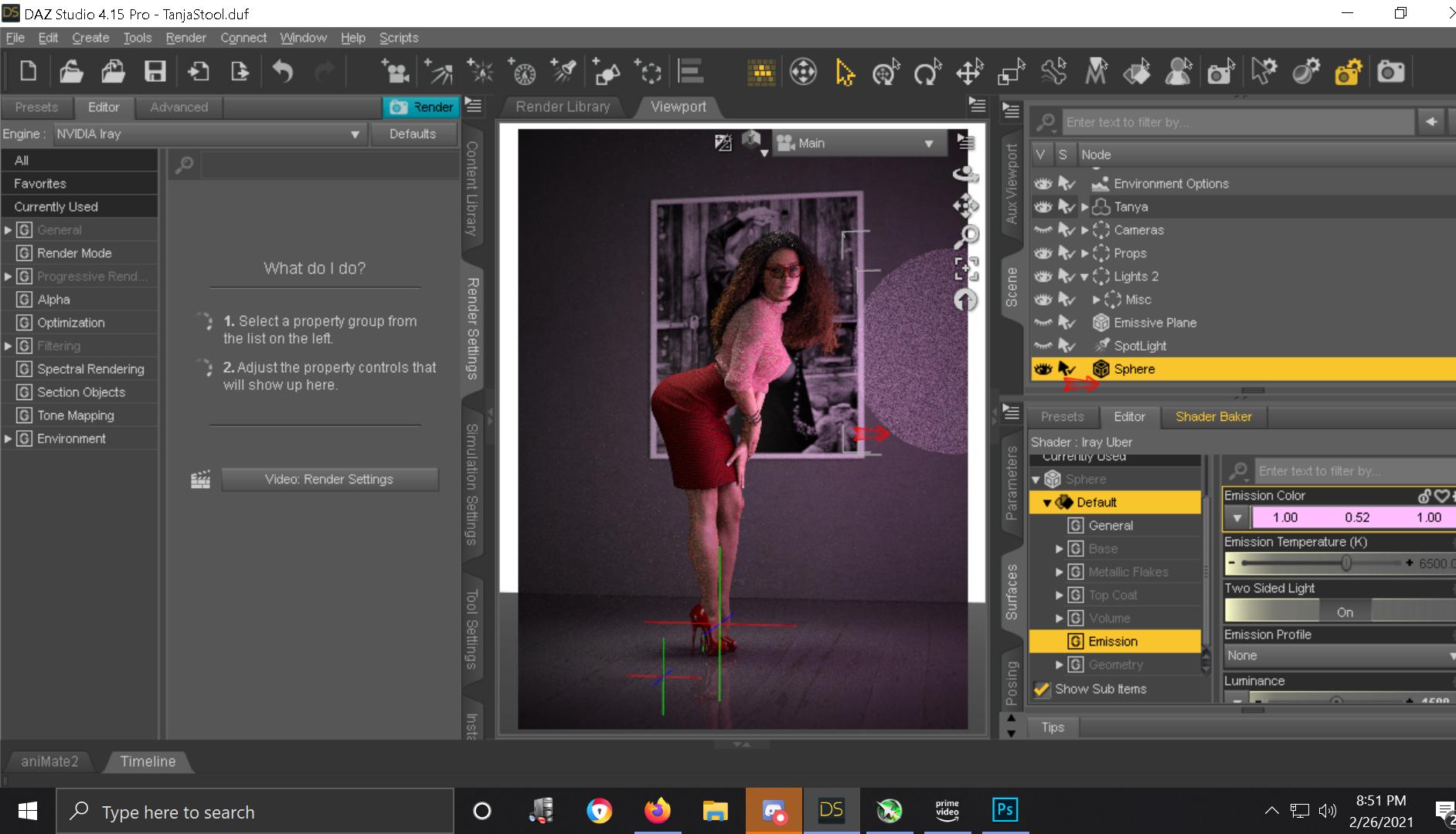

I was wondering if there is anyone who has come up with any way to take out those speckles left by the emiisive primitives, i usually use spheres which leave less speckles than the cylinder does but they all usually leave the spekles

    Thanks Fishtales, that didnt work but i did just put cutoff with a couple of extra zeros to .000001 and no more spekles(at least in this render-you got me thinking thanks!!
    heres an image with surface settings, did i turn off all the glossiness?
    3238 x 2098 - 5M
    Have you considered using a spot light instead of a primitive?
    Create a spot light point it to your figure, Change the light geometry to a sphere. Resize the sphore to you liking. Adjust the luminous flux to your liking.

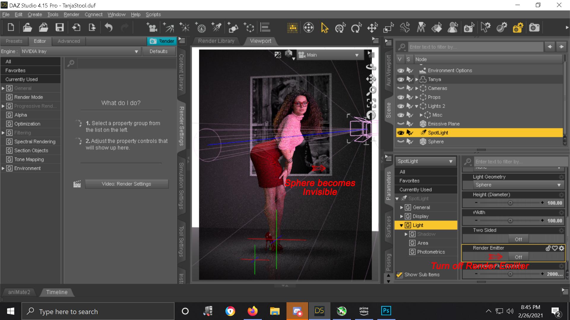

  • JVRendererJVRenderer Posts: 664
    edited February 2021
    Next : Turn Render Emitter off
    The light geometry disappear, but the luminance is still there. Just like a ghost light....without the speckles
    Just for reference: One with an emissive sphere, the other with an emissive plane.
    You will see the faint speckles in these images. vs none with the spotlight with the sphere light geometry (Rectangle, and Disc are also available with the spot light).

    i tried spot lite many times but have trouble with them and then they dont make the shadows like the emissives do or am i not knowing how to make the shadows look good with the spots?
    I started using Daz Studio a little over 3 yrs ago.
    The spotlight default light geometry is a point light. A point light gives very harsh shadows. Swith the light geometry to a Disc or a rectangle and increase the size.  the larger the size the softer the shadows The reason why you see softshadows in emissive is the same.
