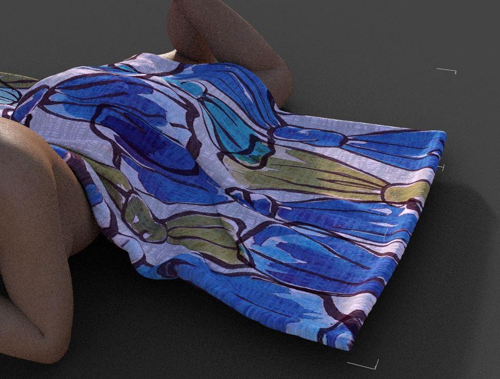

    AbnerK said:
    Richard Haseltine said:
    2 with adjusted uvs would seem the best approach.
    Thanks Richard, It took many tests of various combinations but, remapping and tweaking the settings in Daz along wtih a homemade surface shader finally worked. Seems like a lot of work for a towl but next time it might be seomthing star of the show.
    I got the best result by going to edit -> Object -> geometry -> Add Push Modifier ( in the middle there), then adjust it in Preferences, standard is always too much, but you can make things very thicc with it or fix pokethroughs without meshgrabber. You can also use it to flatten things.
    Btw. if you add a image, make sure its not TOO big, doubleclick it (in edit mode) and change the wide to 400-500 ;)
    Post edited by Loony on
  • AbnerKAbnerK Posts: 718
     Thanks but, that doesn't work very well it just distorts the whole thing and doesn't actually add much thickness.
  • LoonyLoony Posts: 1,817
    AbnerK said:
    well... for me it added always thickness :D
    Okay I tested it now with 2 Towels, Towel 1 did got Fat, Towel 2 did only moved up/down with the push modifier :D
    So you need a other Towel with a better structure!
    Standard:
    with Push Modifier on 1.0:
    And now you have a thick towel ;)
    Add smooth modifier, add subD and set a high res. and then you have a thick fluffy towel.
