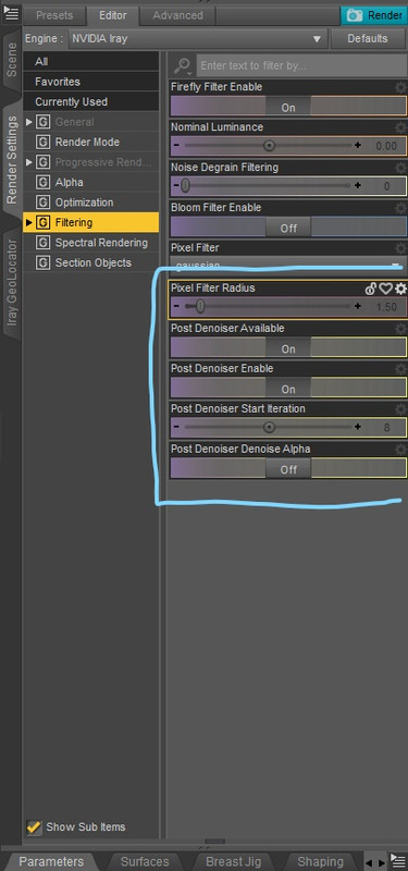

  • You can pretty much get rid of all the details by tuning on Post Denoiser in Render Setting.
    There's more to these setting that I don't really know about so I suggest you search Youtube for Post Denoiser in Daz Studio.
    Also 5000 iteration? I don't remember the last time I render that many.
