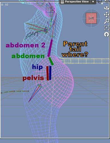

    Holding off on the hips for now but got most of the upper body boned. I do have a question about boning the tail though.
    Where do I parent the base of the tail? The tail comes out of the figure above the buttox. Do I parent the tail bones to hip, pelvis, abdomen, or abdomen 2?

  • JaderailJaderail Posts: 0
    Well in real world terms tails are the spine just carried on. So I'm thinking hips.
  • ghastlycomicghastlycomic Posts: 2,531
    That seems logical.
    If I find after I weight map it that the bone doesn't work where it's parented can I reparent it to another bone without affecting the weight map?
  • Richard HaseltineRichard Haseltine Posts: 109,429
    Yes, though you may well need to adjust the weights to account for a changed origin (if the non-zero weights start away from the centre point you can get an odd ridge; if you have weighting "above" the centre point parts of the emsh will go the opposite way to the main bend).
    Okay that's good. I didn't know if weight maps are like UV maps where any change busts them up. I don't mind modifying them but I'd hate to have to redo the whole thing from scratch because I made a change in the parent order.
    I've parented it to the hip for now. I think it's either got to be hip or abdomen, so I'll see how it works with hip. Almost got all the bones in place. I'm going with a straight thigh bone for now and if it doesn't work I'll try one that follows the angle of the hip.
