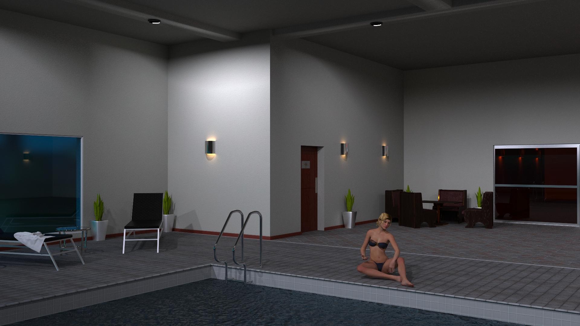

    I use IES Profiles quite a bit and if you choose the right one it works. I have hundreds of IES Profiles downloaded from various light manufacturers website so am spoiled for choice. I use Light Manager PRO quite a bit too to quickly change settings.
    There are two different profiles used in this image. One for the ceiling lights and another for the wall lights both are Emissive surfaces.
    1920 x 1080 - 1M
