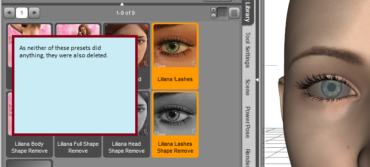

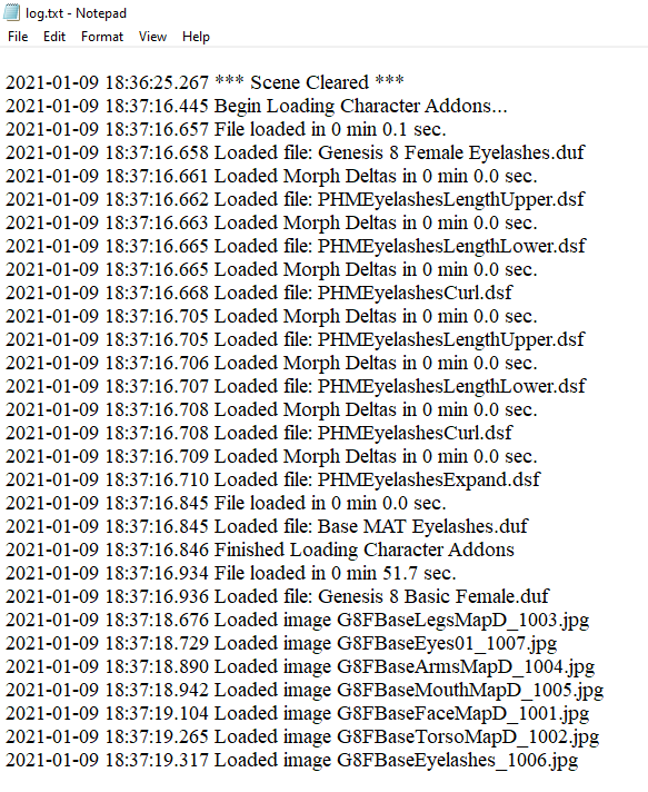

    Okay, thank you. I'll go back and try that. What I did for the moment was delete all references so I could get a load of G8F with "no error messages" :-)
    edited January 2021
    Hmm ... there is no lashes file! Just the H. Mat file. I had copied that over to the main Content folder too, and it does only work as a mat file, does not load lashes.
    I just downloaded a fresh zip too to check the folders.
    So here are my notes of what I did to get rid of error messages. I also deleted a couple of useless shaping files for the eyebrows.
    There were a few references to be deleted. On the last "}" there is to be no comma.
    1564 x 850 - 209K
    1049 x 245 - 18K
    747 x 338 - 174K
    583 x 712 - 75K
