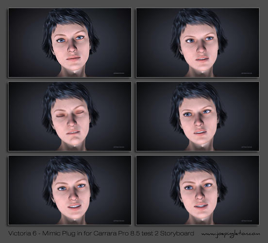

  • JoepingletonJoepingleton Posts: 746
    View the animation on YOUTUBE.COM by clicking here.
    This is my second test of the Mimic Plug in for Carrara Pro 8.5 with Victoria 6. This version is based of the default settings with a few tweaks.
    I tried some of the techniques from my previous lip sync speed tests. These include adding 4 NLA tracks (brows, mouth, blinks and eye movement). The brows track has three NLA clips (Brow UP, Brow Down, Brow Squeeze). The mouth track has two NLA clips (Smile, Frown). The Blink Track on has one NLA clip used at an average of 5 times per second. The eye track has four NLA clips (eye right, eye left, eye up and eye down).
    I also went through the Lip sync from Mimic and removed any NLA clips that lasted less than a frame to try to get rid of the Lip pops that occurred in the first test.
    I think it looks much better than the default settings and only added less than a half hour to the editing time.
    What do you think?

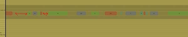

  • argus1000argus1000 Posts: 701
    What do you mean: "removing the spaces between phonemes"?
    edited July 2014
    When Mimic creates the phonemes NLA clips in the timeline there are spaces between them. My idea is to make all the phonemes NLA clips line up to blend between them better.

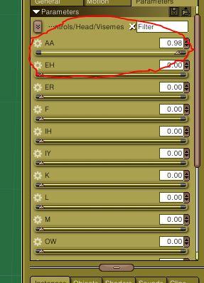

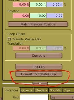

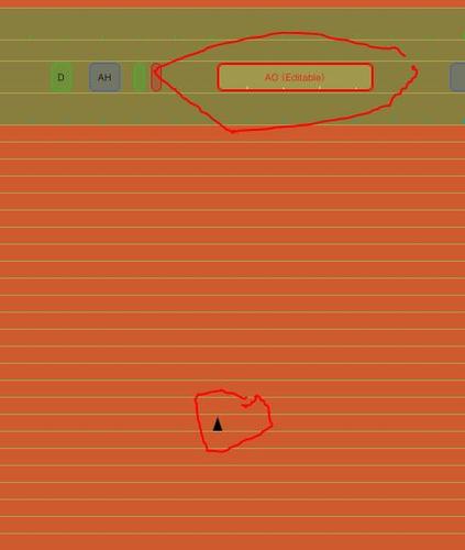

    So you change the size of the space between the phonemes, is that right? (pic 1)
    I see see lip popping though. Have you though of making the phonemes editable (pic 2), opening them (pic 3) and changing the value of the visemes (pic 4)?
    Yes I did like you show in pic 1. The popping could still be coming from some of the short NLA clips. My plan was to get rid of those next.
    I hadn't tried what you suggested in pics 2 -3. I was trying to keep the process as simple and quick as possible. But I think your on to something and will have to try it out.
