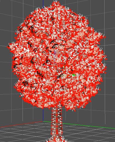

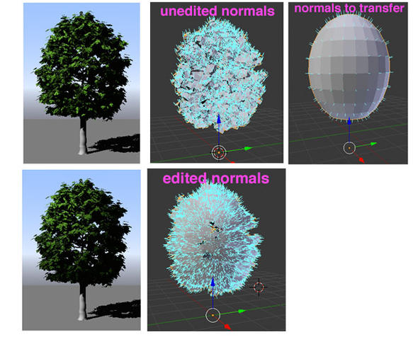

    evilproducer - here is a quick and dirty example of edited normals (I'm no expert here...).
    I took the leaves from a tree, brought them into...another app, then used some add-ons to "transfer the normals". As you can see, it creates a different kind of lighting. It's subtle, and you can imagine how it could be quite stylized and lovely. In these examples, the polygon normals have been edited. You can also edit each individual vertex normal if you want, to say, change the shading on a flat plane, light at the top and darker at the bottom.
    Sadly bringing these edited objects into Carrara, as you can see, does not respect the edited normals. I hope I'm wrong though, and there is a magic switch I am missing.

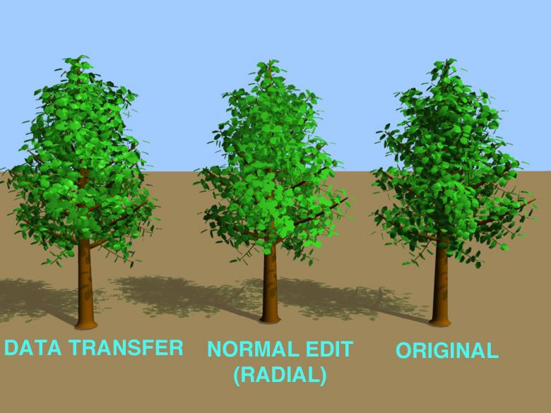

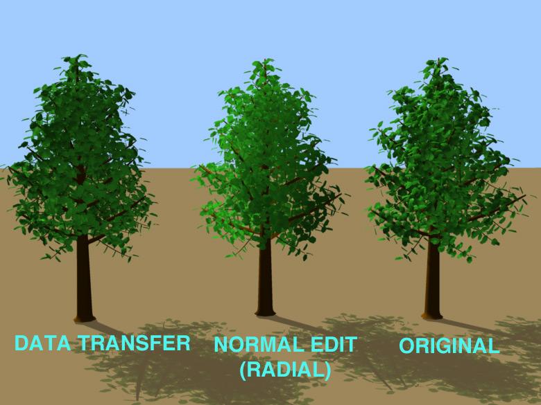

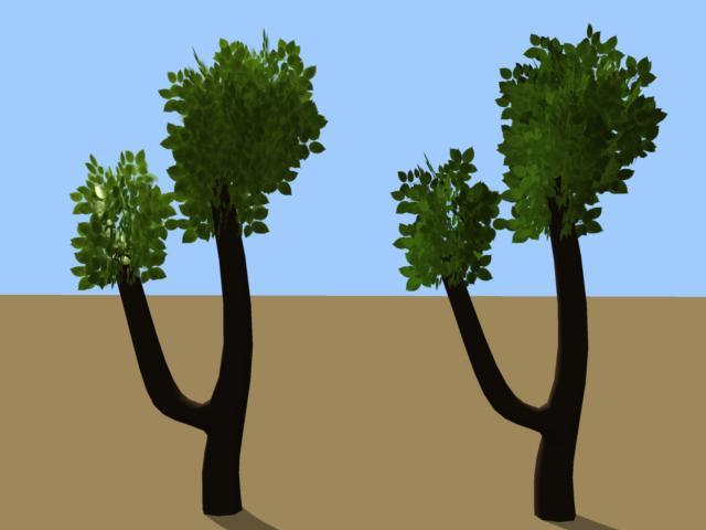

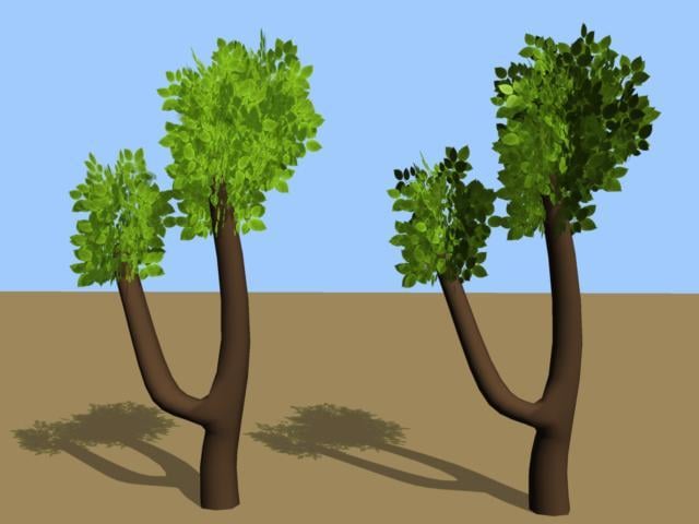

    Sorry to ressurect this thread, but Carrara can read edited normals, but only from an imported OBJ file and only if you select 'Facet Meshes' when importing. I was fiddling with this again last night (...don't ask, lol) and got it to work. You have to step outside of Carrara for a few clicks in Blender, but you can get your object back in with edited normals intact.
    If anyone is interested I can make a mini tutorial. Also don't want to violate any TOS if I have to mention a few steps in Blender...and I flubber around in Blender when there...
    Here are few examples - it's not 'all that' - but at least it can be done if one wants, like the original OP asked.  smiley
    The first two pictures show the original Carrara tree, the middle tree used the Normal Edit Modifier, and the far left tree used the Data Transfer Modifier where I transfered the normals from a bell shaped object.
    The third and fourth pictures use a very hastily thrown together low poly tree using flat planes with alpha mapped leaves. The tree on the right is the Carrara tree and the one on the left has had the Normal Edit Modifier applied, then brought back into Carrara.
