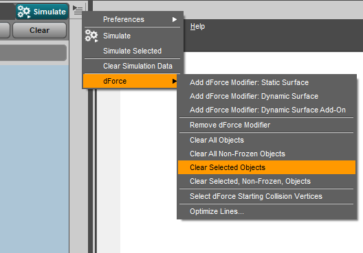

    3.  And you can clear a simulation for a selected item.  Not obvious at first but very handy and notably missing from the DAZ tool.
    The ability to clear simulation data on a selected object is NOT missing from the Daz tool. It is just kind of hidden in the Simulation Settings context menu. I believe it was added in 4.12.1.44, according to the change log.
    528 x 369 - 22K
    Post edited by barbult on
  • marblemarble Posts: 7,500
    I have a shortcut in my toolbar for that (Clear Selected). Simulate Selected has been added since and is very handy so long as you remember to select the figure (all collision objects) and the garment.
