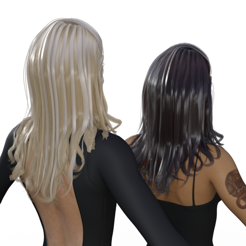

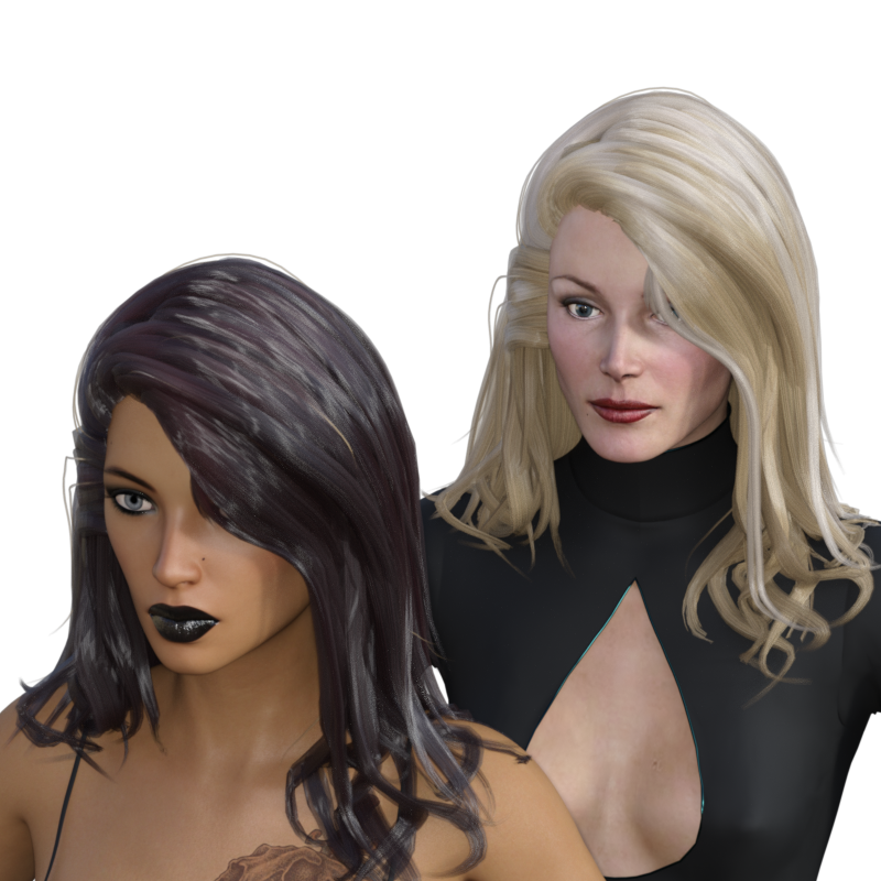

  • I have fitted the new hair to G8F, and it's shown in the 3 renders below. The blonde hair is Jim Burton's original Las Vegas hair on Glamorous Vicki 3 (a 16+ year old Victoria 3 based character) the dark version is the converted one on FWSA'S McKayla for G8F, including the Toulouse Hair skull cap and all the Las Vegas morphs applied. So far as I can tell, it works as a native G8F hair, shrinking and growing, twisting and bending as you'd expect a conforming hair to do as you change the character and pose.
    Regards,
    Richard.
