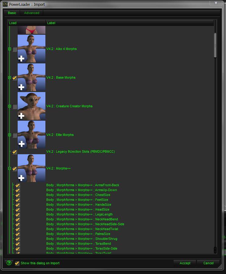

    A power loader would be most helpful. like the older generation 4 characters have. that allows you to pick which morphs you want to load.  I wonder why they stop using a power loader?
     it took about aminute for 4.14 to load g8F on my systems . But a powerloader I think would reslove a lot of that load time issue
    742 x 899 - 86K
