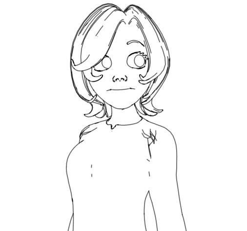

1) to generate some line drawings that will be similar to the sketches my client has already made
2) and to render non-photorealistic diffuse for main animation to brin into After Effects.
One thing we're considering is using a sketch as a 2D background and then just one or two elements like a person walking or talking (with a shadow catcher as necessary).
Would welcome any general suggestions, as well as any specific recommendations regarding shaders. Client really doesn't want extra shading / texturing. Didn't know if it would make sense to just retexture in photoshop so very simple with pretty much one skin tone or any other tricks people would recommend.

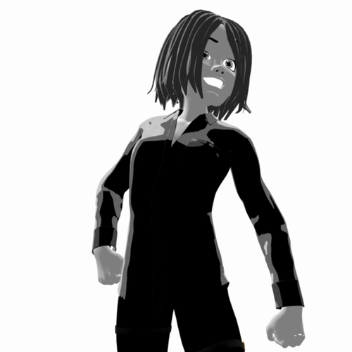

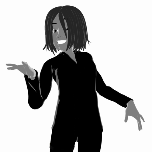

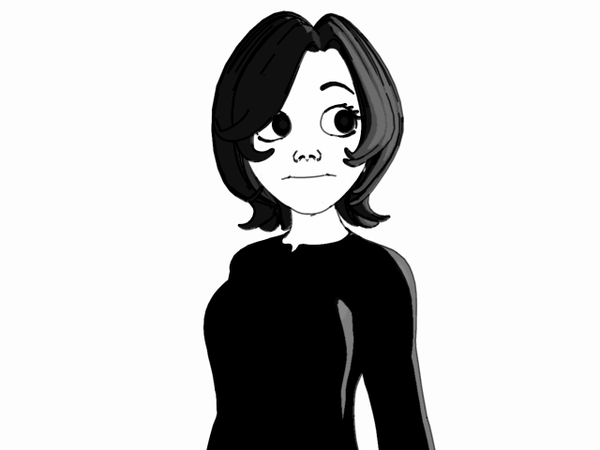

    the "fuzzy" pic is the NPR renderer. I don't think you would have any success trying to animate it, but if you used Wendy's suggestion of CrazyTalk then you can create most of your scenes from still renders...
    the clean outline is just the ToonPro renderer. The solid pic is the ToonPro renderer and some ToonPro shaders...
    431 x 470 - 30K
    506 x 474 - 51K
    418 x 446 - 43K
    edited June 2014

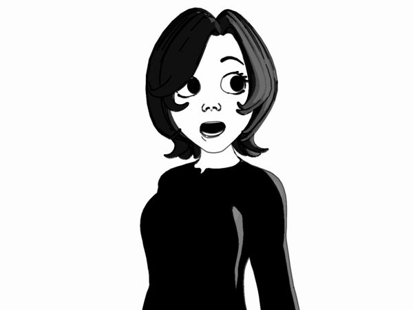

    Here is ToonPro shaders reacting to a single light in the scene to provide some depth/edge highlight...
    640 x 480 - 46K
    640 x 480 - 46K
    Post edited by wetcircuit on
    One more, separated the eyewhite and skin shaders... This is straight out of Carrara. No post.
    640 x 480 - 38K

    yes, I think the plugin times out after 10min or maybe after a certain amount of rendered pixels...? Not sure. The limited pixels (on certain plugins, not sure which) include preview renders in the shader room :/ and the spot renderer in the main room - so it runs out very fast....
    The figure above is a standard poser-verse figure called AikoToon available here in the DAZ store.... Any figure/model you use in Carrara you can do this to.
    The plugin has some settings, in the renderer you have the option of "nesting" a photoreal render within (under) ToonPro. There is a toggle switch at the top of the secondary (photoreal) render settings to do a base render. By "base" they mean do the second render with the settings that follow. Turn that off and you won't get the "textured" render. You can however get the alphachannel from that base render, so you have a toon render that is ready to composite in AE, etc....
    I haven't used Animator, but yes that is the idea, render out the basic parts and use Animator to rig a 2D puppet. There are videos on Reallusion's site. The FBX/iClone workflow is just so you can import iClone motions into Animator. You don't *need* those programs to use it.

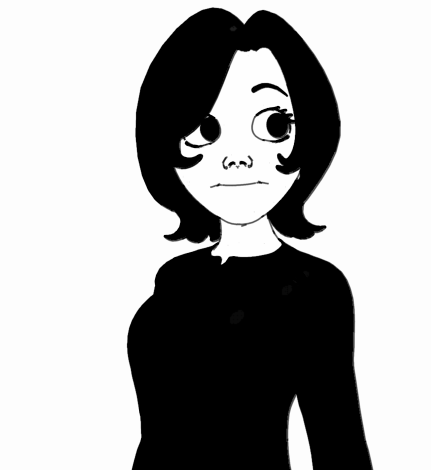

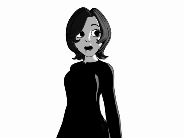

    All of those are really cool Holly! I may have to look at that plugin. Do you know if you can still get it for Carrara 7.2?
    edited June 2014
    Yep. Still has downloads for Carrara 6.2, 7.2, 8.x
    I've had this plugin forever and used the outines, but never really played with the shaders... I wanted to do a b&w projects like this for a while...
    640 x 640 - 79K
    640 x 640 - 65K
