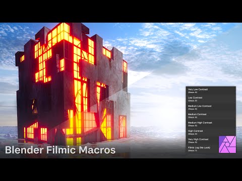

  • SevrinSevrin Posts: 6,313
    For Affinity Photo, I use the macros linked in the description linked in this video by Affinity Photo's product expert at Serif.  It's a one-click solution and no plugin is required.  There are a few options ranging from low to very high contrast, and you can dial them out a bit if you find the effect too strong.
