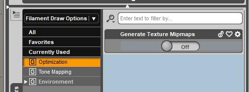

    Turning off mipmaps gets rid of the seams in character skins for me (in the Filament veiwport and render).

    Huh.  Interesting.  What bump strength do you have?  Have mine at 2.  Also how zoomed in are you?  From further out my seams aren't that visible but zoom in like your head is next to seam in RL, and it's very visible.
    Did not update/merge menus yet (is thay why?)_, so I had to use create menu to add the "Filament Draw Options" node.  The Tonmapping & Enviornoment Nodes were added auto from start.  Use the Create menu for all kinds of things so can't see why different.
    So with Filament Draw Options Visible, did toggle the MipMaps off/on, and flipped between render engines, and preview styles a few times in case something needed a refresh.   Still no change.  Whereas Bump map change to aero again makes the seam 100% disappear.   Also did a render but with it set to viewport, result was identical.  Seam is there.
    Your experience is the opposite of mine! I used Latonya 8 in these screenshots. With mipmaps on, she has bad seams. With mipmaps off, her skin seams are completely gone, without making any change to bump or normal. However with mipmaps off, there are lots of moire type artifacts. These screenshots are with Texture Resource all the way up on Quality.. When I zoom in, even with mipmaps on. the seams go away.
    With mipmaps on, so the seams show, I changed the skin bump from here default 5 to 0 and changed normal from her default 1 to 0. It made no difference that I could see. The seams were all still there.

    Mine is acting just like Barbults, if I turn off the mipmaps the seams disappear turn it back on they reappear.  I had originally messed around in the surfaces turning everything off and it did not fix the issue.  This was with Millawa.

    I did update/merge menus and opened and closed several sessions.  Just in case need to activate something in backend.  Doubt it.  But just to be safe.  That said I still don't get the auto addition of Filament Draw Properties.  So I added again via Create sumbmenu.  When mipmaps is toggled, it redraws the filement preview every time.  So it is recognizing it.
    Interestingly, Victoria 8 is pretty much without seams.  Very hard to see.  Freja & Josephine are the worst and very visible.  Babina head is perfect without a seam, but arms have slight seams.  I did disable skin normals maps for all, and standardized Skin Bump to 2.0 for all.  And all these screenshots is with MipMaps off.
    The stark difference in visibility of seams between these Das Originals would lead me to believe they likely have different UV padding values when they were baked.  Did not look because, I have so much other stuff to do.  But with you guys being here and testing stuff, I put my stuff aside so I could at least test too.
    Any chance either of you have Freja or Josephine?  And could test sometime?
