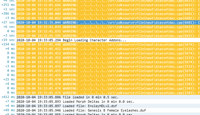

    Interesting! i did a zero start with a single character and it takes minutes of message warnings and less than 30 seconds to load, after the almost 3 minutes of warnings of course, I dunno what causes this, the messages states something that I don't know how to fix, I have my runtime AND DazStudio in drive D not C.
    Thats the messages appearing and consuming minutes...
    My character is not heavy morphed, all that you see is all that she conforms, below after "static surface" is only ichigo hair posing and styling parameters
