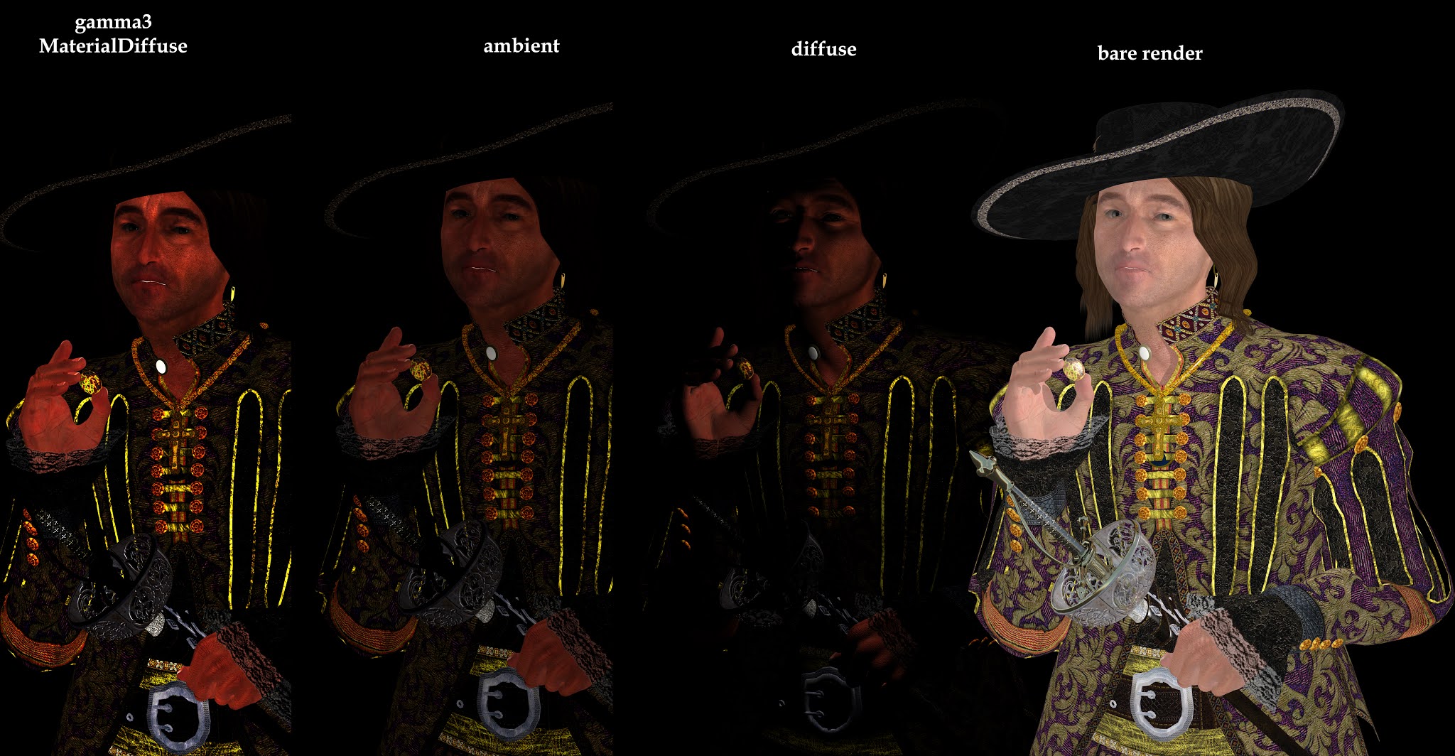

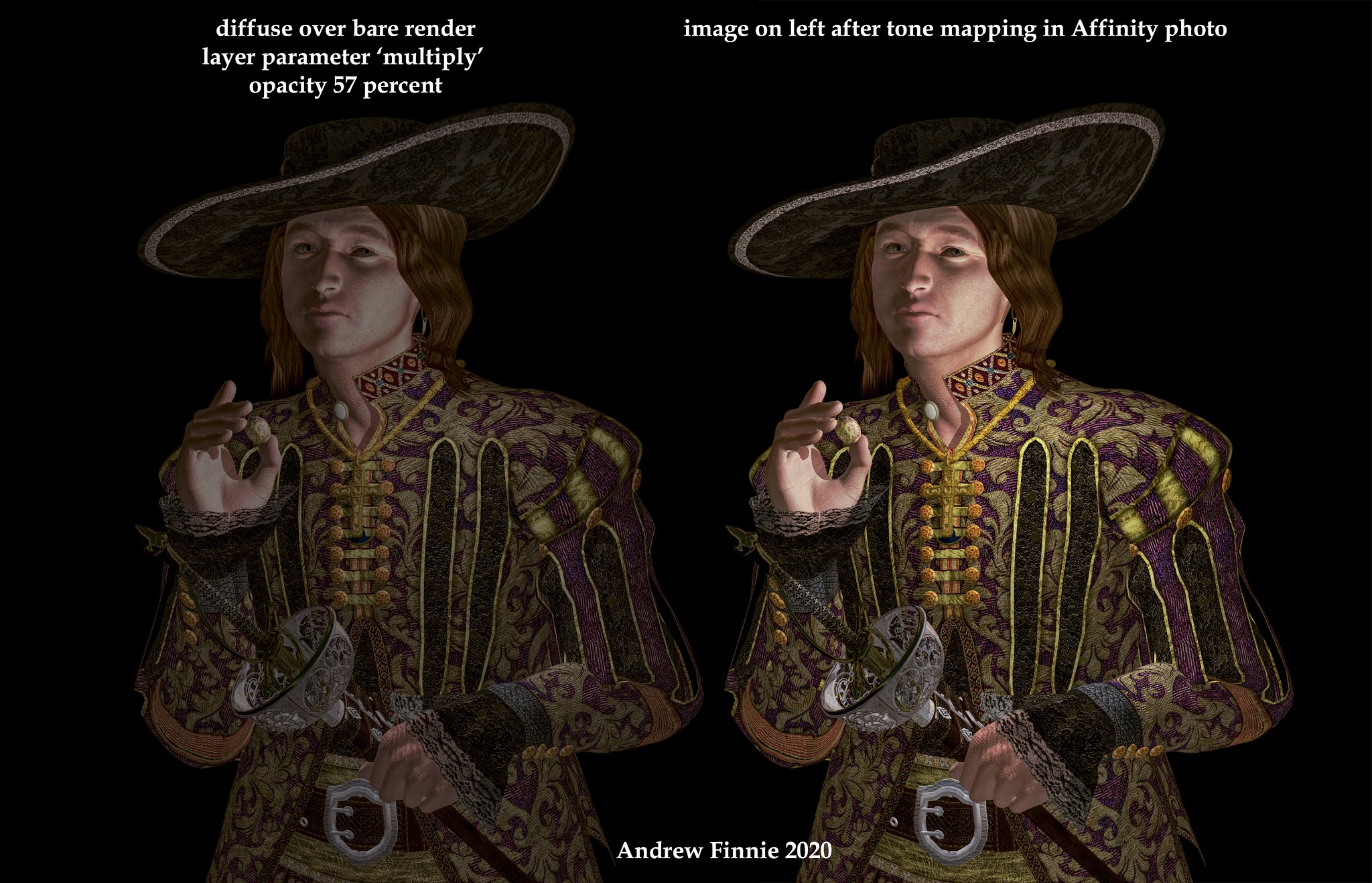

    Here is the diffuse pass overlayed on the bare render (both using gamma 1, 100 percdent ambient and one light bulb).
    The diffuse pass layer was set to 'multiply' and the opacity lowered to 57 percent.
    I used affinity photo tone mapping to finish off the image to bring out the darks etc.
    In Affinity Photo tone mapping means you can compress or extend the tonal range (so darken the highlights if you want and lighten the darks etc)
    You can also play with the local contrast which can bring out pores in skin etc,

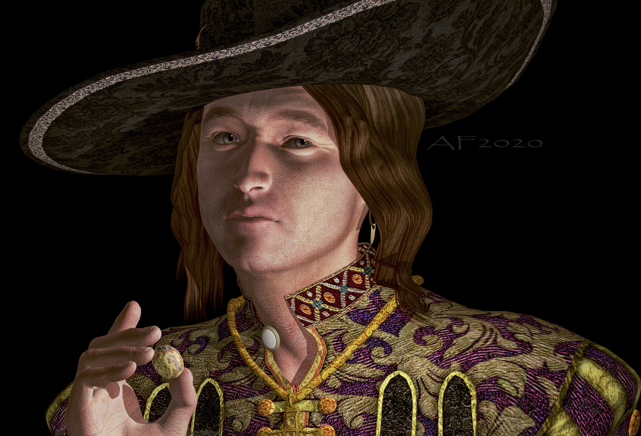

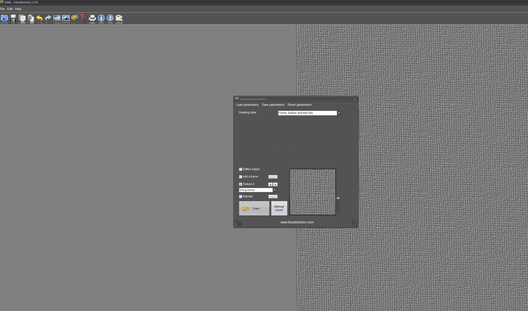

    Finally we fill a new layer with 50 percent grey and take into fotosketcher (free program)  http://fotosketcher.blogspot.com/
    There we add a canvas texture to the grey layer and bring that texture back and place it over our image.
    We make the canvas texture 'overlay' mode. That means that anything darker than 50 percent grey will darken the underlying image.
    Anything lighter will lighten the unferlying image.
    We then paint in the eye highlights. The highlight itself will be a spot of light reflected from the cornea.
    That spotr of light is reflected by the cornea and hits the iris as a softer more diffuse light.
    Other stuff we can fix later in this image is the atrocious hair (I chose it because it looks so artificial) - we would use the object render pass for that to select just the hair.

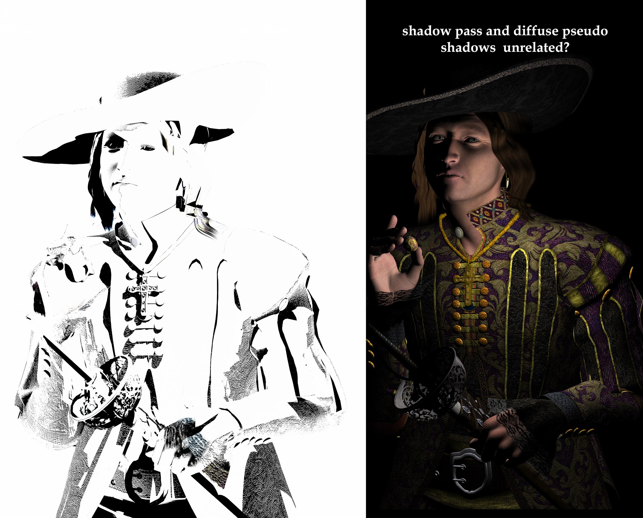

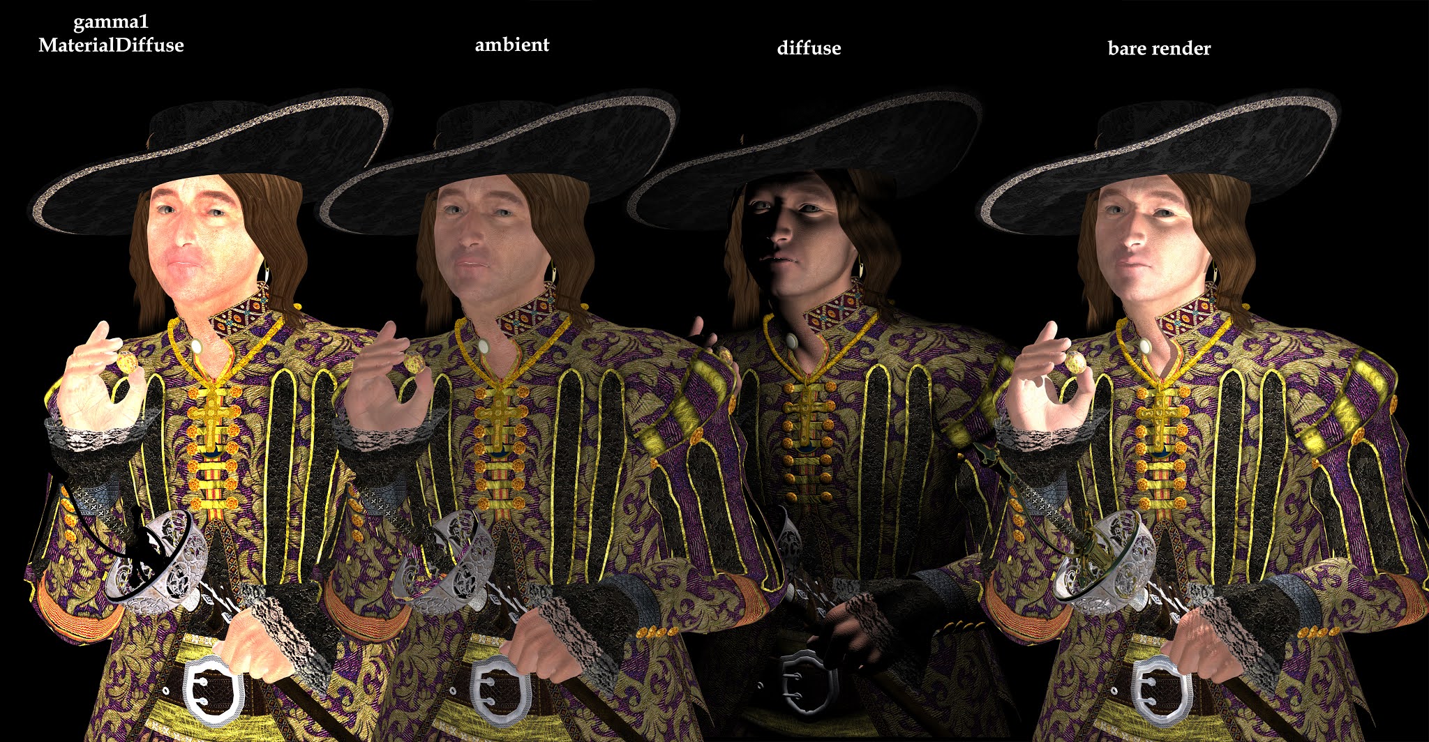

    Here's a play I had today. All the images were rendered with 100 percent ambient.  Bare in mind I am designing these images so I can work on them in post.
    I know that we are not supposed to use much ambient - but I don't agree ! (looking for a quick way to render and also looking for an illustration style)
    There was one light source (a bulb). I was looking at doing a shadows pass and overlaying it on either the clean pass, or the ambient pass to demonstrate what you could do with the two layers.
    Anyways the shadow pass turned out like crap (i'll go back and do it with a distance light) .
    It was howevere good for selecting highlights and darks so I could make the shadows more eg purple. etc. You could also add a gausian blur to make it more subtle.
    I did get some happy (unexpected) results though by changing the gamma settings.
    The low gamma setting of 1 gave me much more detail in render diffuse render passes, than did the gamma 3 setting. Though it blew out the highlights in the 'bare render'.
    The pictures are big if you want to click on them.

    It's probably me but I always found Carrara's Shadow pass to be weird and clunky chunky. I think it should be called a 'Cast Shadow' pass.
    There doesn't seem to be a straight up 'self shadow' pass, or,  what may also be known as 'form shadows'.
    For that I create a simple White Shader - just pure white in the Color Channel and turn everything else to 'None'. Apply that Shader to everything in your scene.
    Turn you backdrop to pure white as well.
    Save as a seperate file(!).
    Render that out and apply to your liking in post.
    I'm pretty sure it was you who gave me the tip to render Cast Shadows using a white backdrop and turning the Keylight up to 1000% or so, dialing down to one's taste and maybe using soft shadows. Then apply that ontop of the form shadow pass? It's been a while since I have tried.
    Beautiful work as usual Headwax!
    Edited to add: And turn off 'Casts shadows' for all the objects!

  • HeadwaxHeadwax Posts: 10,435
    Headwax said:
    Looking at the gamma 1 diffuse render pass gave me what looked like a great start for the shadows - they were soft and pleasing.
    I knew I could use them to work up the 'bare render"
    Oddly they didnt seem to have much to do with the real shadow pass.
    Luckily because, as mentioned, the shadow pass was ugly.
    I am not sure where Carrara is getting the data for the darks in the diffuse pass?
    thanks for that, glad it's not just me who fibds the shadow pass clunky - will sit down and experiment with different light types when I get a chance - had good results in past by rendering with different lights on the same scene and then saving the resulting shadows passes and adding them together in post with a spot of blur as well from memory
